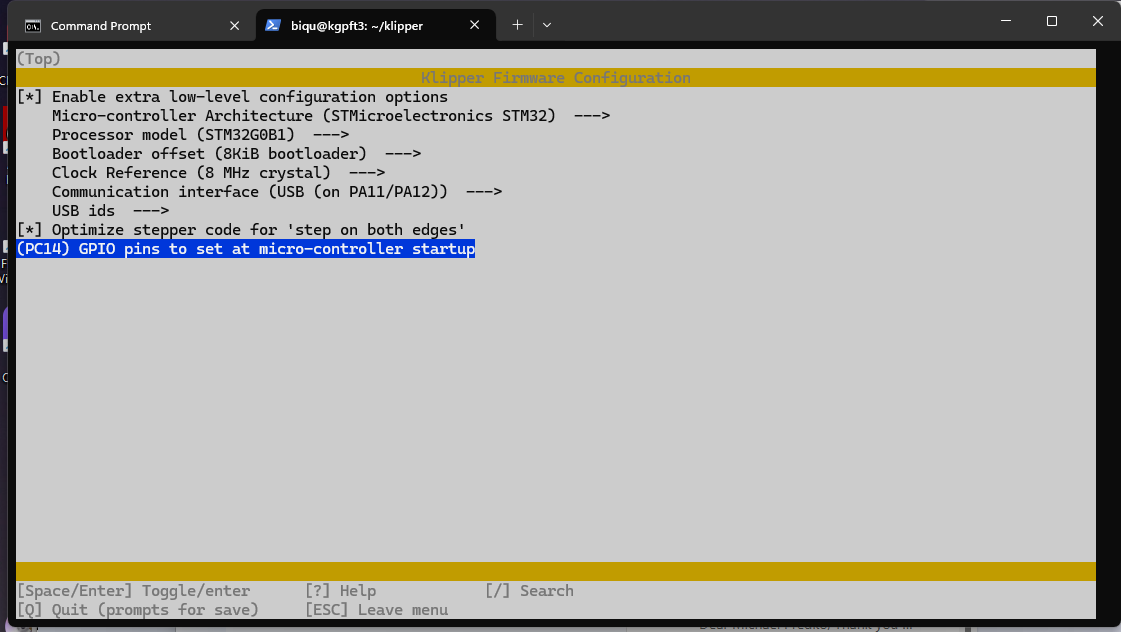

I’m gonna be a little unorthodox here and have you create a Klipper firmware image on your Linux desktop - you can do it on the CB1 but once you create the firmware image you’ll have to transfer it to the Linux desktop or PC to put on an SD Card.
You might as well install Klipper on the Linux machine and create the SD Card from there.
Open a terminal window on your Linux machine and install KIAUH by following the process:
Next, start KIAUH (./kiauh/kiauh.sh) and “Install” just “Klipper”.
cd ~/klipper and enter make menuconfig and set up the menu with:
Once done, press “Q” followed by “Y” and then:
  • make clean
  • make
This firmware image is basic Klipper with a USB connection and turns on the STATUS LED on the board.
Then set up an SD Card (ideally no larger than 4GB) with FAT32 and 4096 block size and follow the update procedure from the User Manual:
So, if everything works, then you’ll have your MCU ID and a lit LED.
Otherwise, you have a problem with your MCU and the board.
