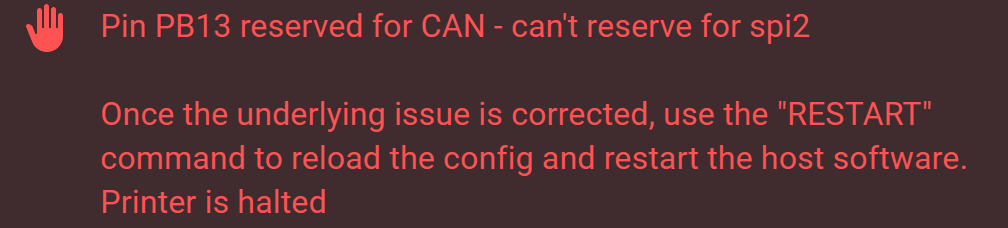

Do you have checked your printer.cfg related to PB13?
I suppose it is a duplicate entry :thinking:

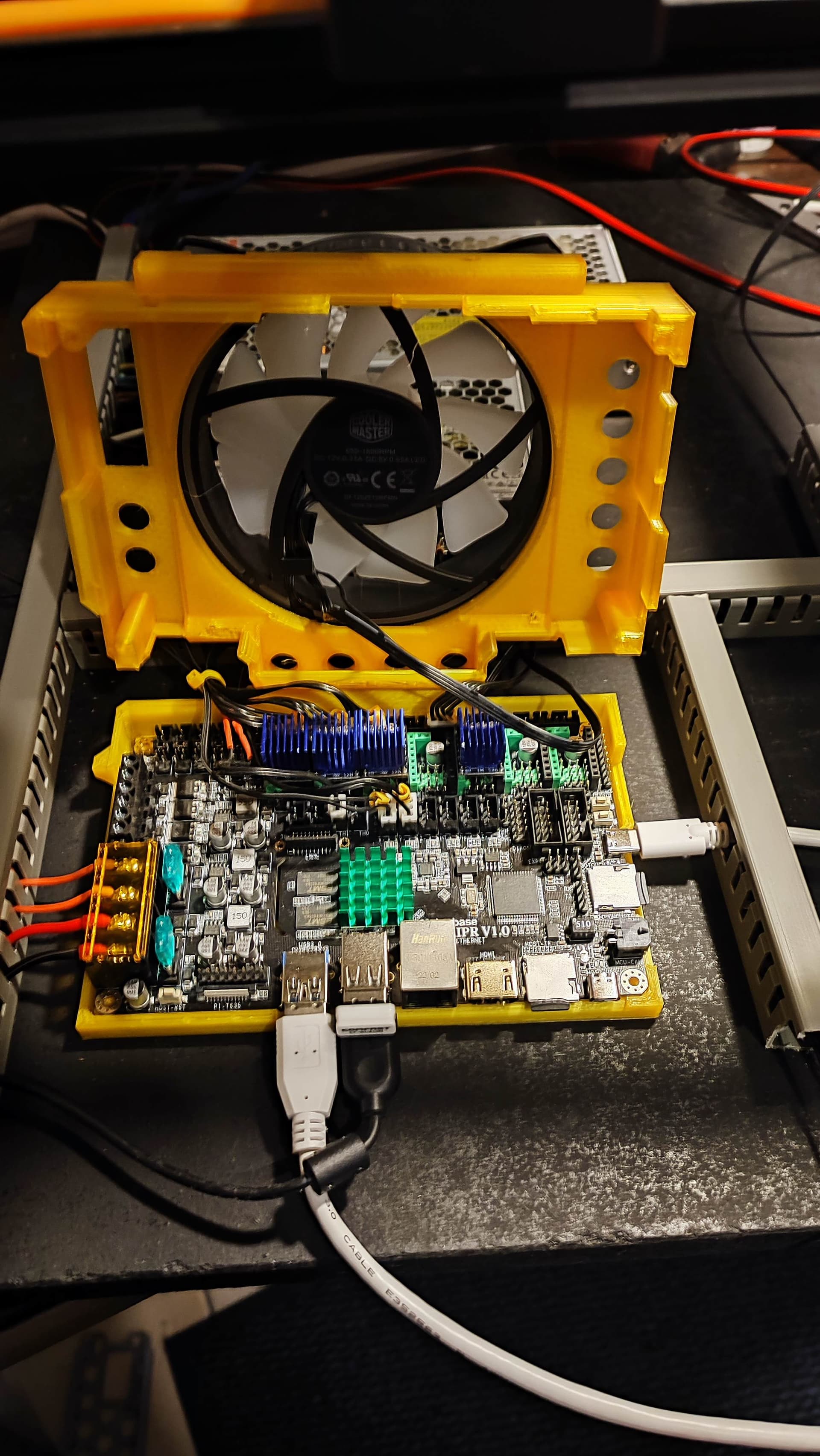

Now I have successfully connected my Mellow Fly SHT42 toolhead to the SKIPR CAN connector!
  • at the SKIPR mcu klipper is builded with your patched can.c
  • at the sht42 toolhead klipper is
    builded with the original can.c
It seems to be working :grinning:

I’ve attached my config.
With the use of my U2C USB to CAN adapter the config already worked.
I could read my driverstates and control a neopixel connected to the toolhead.
And if i look at the klippy.log, it’ll try to reserve canbus and spi on pb13 on the toolhead.

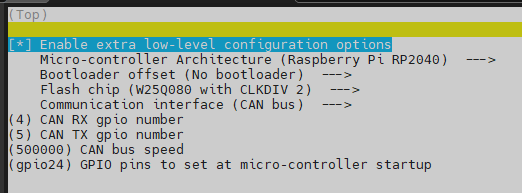

Does anyone have a chance to test with Fly SB2040? I couldn’t get it to recognize even though have checked the patched branch.
Here are the steps:
  1. I checked out the patched branch and compiled firmware for MCU with the below setting
    Screenshot 2023-01-16 180502
    Also, I plug the USB from MCU into the Pi side. Everything worked.
    Screenshot 2023-01-16 180526
  2. I compiled firmware for SB2040 with the below setting and successfully flashed it to SB2040.
    Screenshot 2023-01-16 180417
    Still, only Klipper UUID is found. I have tried to plug and unplug the 120Ohm resistor on SB2040 and still, nothing worked.
    I just hope that I do not make a mistake somewhere
