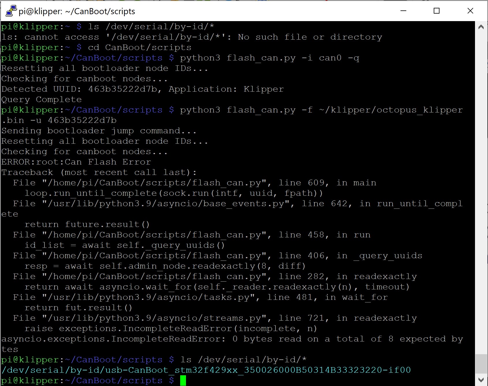

@koconnor Hope I’m not bugging you by posting here. My issue is with an Octopus Pro F429 board using CanBoot and Klipper USB to CAN bus bridge communication. EBB36 connected to can0 via the bridge.
When trying to flash Klipper updates (or CanBoot updates) to the bridge MCU it isn’t very straightforward.
The bridge MCU and EBB36 show up on can0 network with CAN uuid. Trying to find serial device path gives “no such file or directory” as expected. If I try to flash a Klipper firmware update with:
python3 flash_can.py -i can0 -u <uuid>
I get the following error:
But that does enter the CanBoot bootloader and now the serial device path is present…allowing me to flash with CanBoot serial command:
python3 flash_can.py -d <serial device>
And now Klipper flashes and the bridge goes back to CAN uuid.
Is this just how updating will have to work with the bridge MCU? Would be great to only have to send one command…to enter bootloader and flash over serial…from CAN state.

Yes, flashing a “usb to canbus bridge” mcu via CanBoot currently requires the two steps you outlined above.
It should be possible to automate, but I don’t know of anyone currently working on that.
