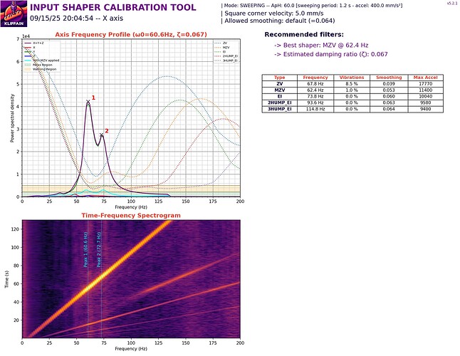

Ok here’s Klippain Shake n Tune plots. First is lis2dw, second is adxl:
The lis2dw has wideband noise below 50hz and is contributing to the higher psd at 5-20hz. It also has spurious peaks all around the main real one, not to mention one that is decending with time (resonant frequency decreasing while calibration excitation resonance is increasing? what??).

@nicefig thanks for starting this off. I have confirmed that the software fixes to the LIS2DW code appear to make the LIS2DW perform the same as the ADXL345. I used the BTT345 and BTT2DW to confirm. I consider this initial verification as I would like to further test with toolhead boards to get a more complete picture.
Comparison of LIS2DW and ADXL345 - klipper update.pdf (420.0 KB)
So at least the graphs and the results of shaper selection now match. That is good.

ok better late than never.. here’s my testing which confirms the positive results of the fixes.
as i am late, i took the update from mainline v0.13.0-374 which is well after the fix. initially misunderstood the instruction to update the mcu and only did the mcu and mcu host, but after flashing it to the accelerometer mcu, (rp2040 on the BTT lis2dw) problems went away. thanks @koconnor and all…
v0.13.0-255(blue)→v374(red).
5 second static measure to verify the output data rate. 388-404Hz → 1592-1597Hz
klipper resonance test
shaketune
