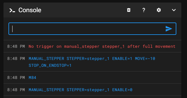

I can disable the driver using:
MANUAL_STEPPER STEPPER=stepper_1 ENABLE=0
Which does turn off the stepper driver.
But when I again try:
MANUAL_STEPPER STEPPER=stepper_1 MOVE=10 STOP_ON_ENDSTOP=1
I get the error:
No trigger on manual_stepper stepper_1 after full movement

Thanx for the reply but I’m still not seeing what I’m expecting.
I tried:
followed by:
MANUAL_STEPPER STEPPER=stepper_1 MOVE=10 STOP_ON_ENDSTOP=1 ENABLE=1
With no movement and the message: “No trigger on manual_stepper stepper_1 after full movement”
The stepper motor driver is engaged.
Just running:
and:
MANUAL_STEPPER STEPPER=stepper_1 ENABLE=1
Does disengage/engage the stepper.
Movement commands like:
MANUAL_STEPPER STEPPER=stepper_1 MOVE=15
Work fine.

  • I think there’s an issue with not resetting the StallGuard registers before issuing a subsequent move looking to home. In the sequence below, I have done a homing operation and then turned off the stepper by first using the command MANUAL_STEPPER=stepper_1 ENABLE=1 MOVE=10 STOP_ON_ENDSTOP=1and then turn it off using the “Engine Off” icon in the Toolhead Window. Then I do the homing operation again (which there is no movement) and get the response:
