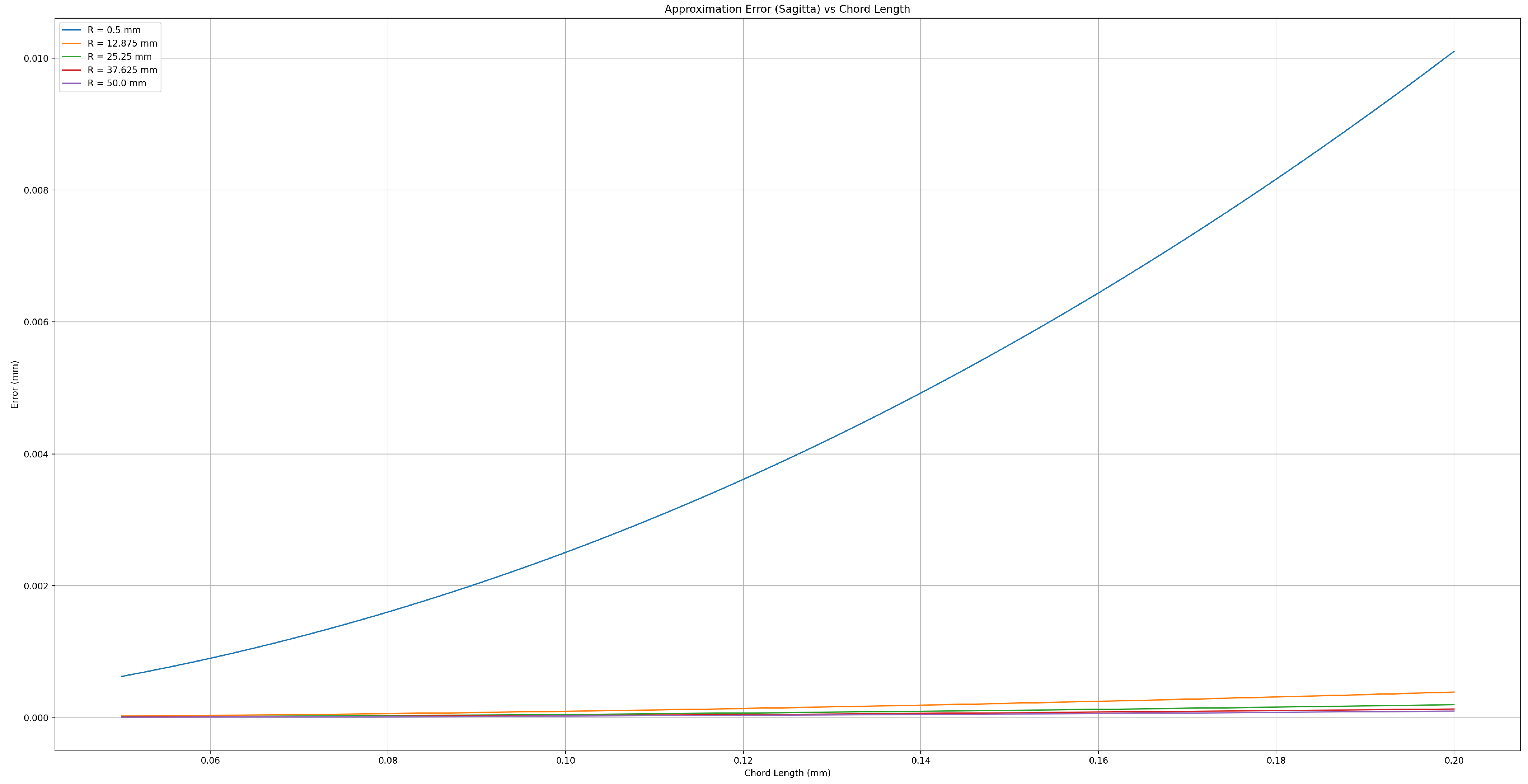

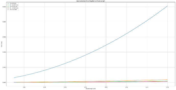

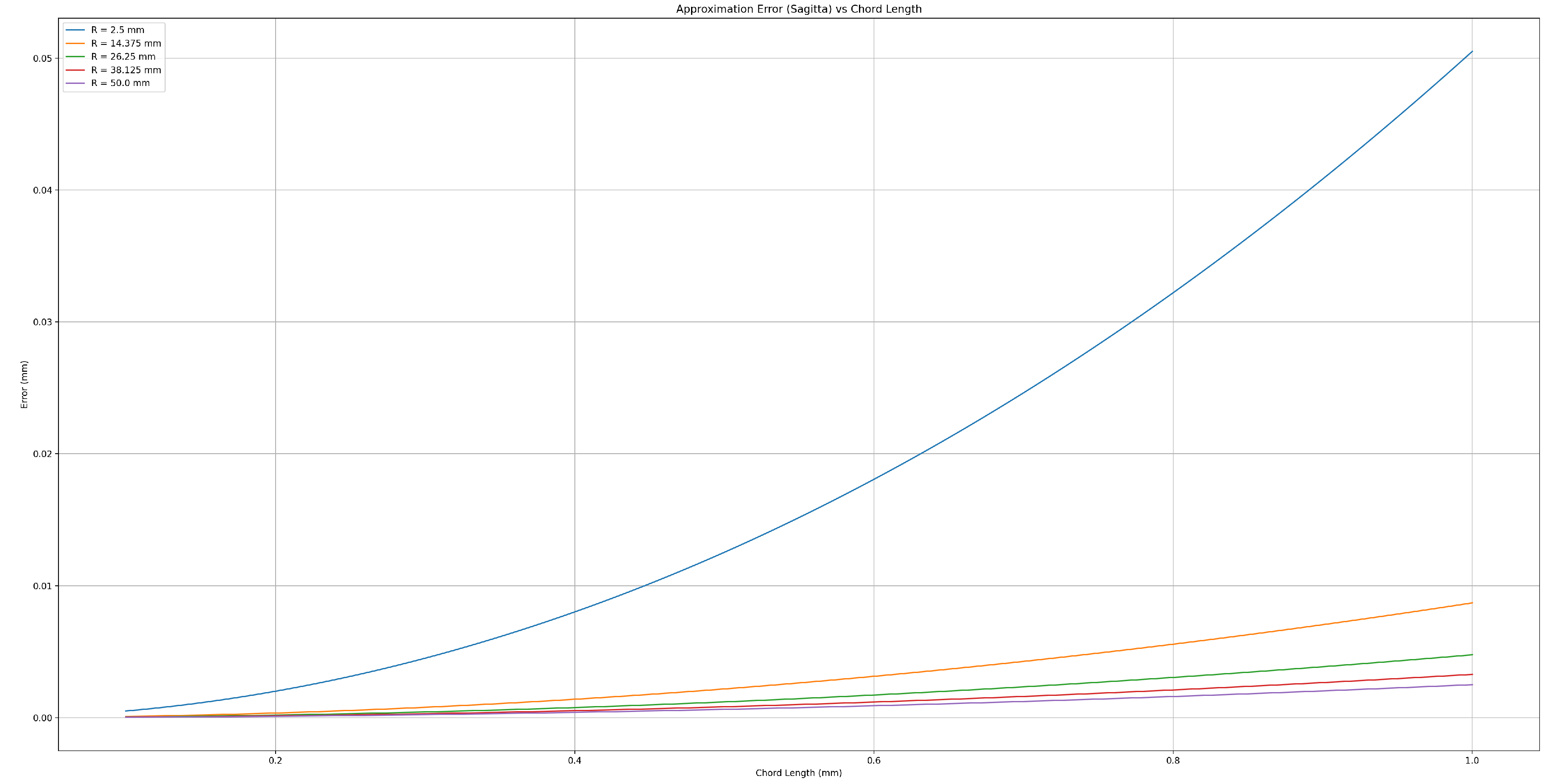

By default, gcode_arcs uses resolution = 1mm.
With some adequate radius circles, we can calculate the maximum error.
For me, for 3d printing, dimensional error < 0.1mm seems acceptable.
I personally think that 0.1mm resolution is better from the approximation endpoint.
But it does put additional load on the host.
Minimal radius 5mm.
If you do, decrease the chord length to 0.1 mm, you can generate even smaller circles, with a minimal radius of 0.5mm:
Python code
#!/usr/bin/python3
import numpy as np
import matplotlib.pyplot as plt
# Constants
min_diameter = 5  # mm
max_diameter = 100  # mm
chord_lengths = np.linspace(0.1, 1, 100)
radius = np.linspace(min_diameter / 2, max_diameter / 2, 5) # mm
# Sagitta function: s ≈ R - sqrt(R^2 - (L/2)^2)
def sagitta(R, L):
    return R - np.sqrt(R**2 - (L / 2)**2)
# Compute sagitta for each radius
errors = {R: sagitta(R, chord_lengths) for R in radius}
plt.figure(figsize=(10, 6))
for R in radius:
    plt.plot(chord_lengths, errors[R], label=f"R = {R} mm")
plt.title("Approximation Error (Sagitta) vs Chord Length")
plt.xlabel("Chord Length (mm)")
plt.ylabel("Error (mm)")
plt.grid(True)
plt.legend()
plt.tight_layout()
plt.show()
Maybe it would make sense to limit the path error instead of directly specifying the chord length in the config. But this is not directly related to the topic.
