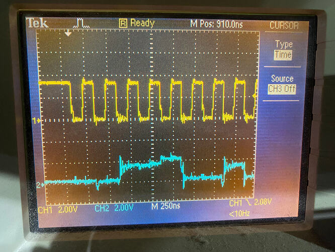

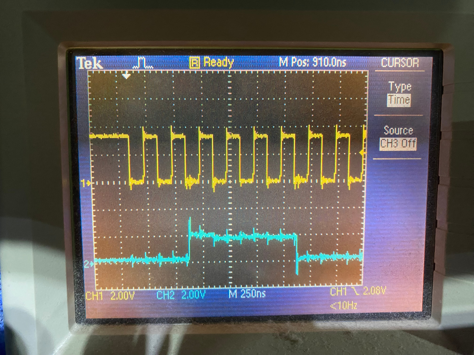

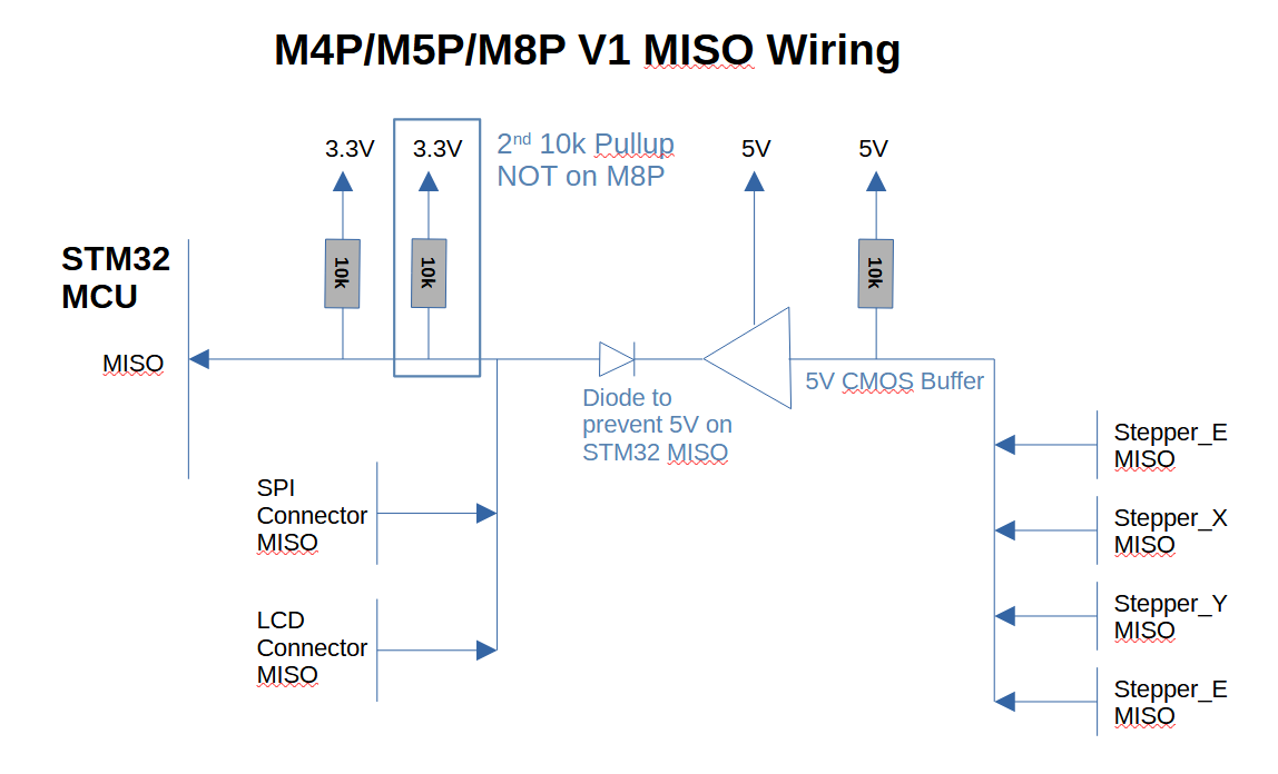

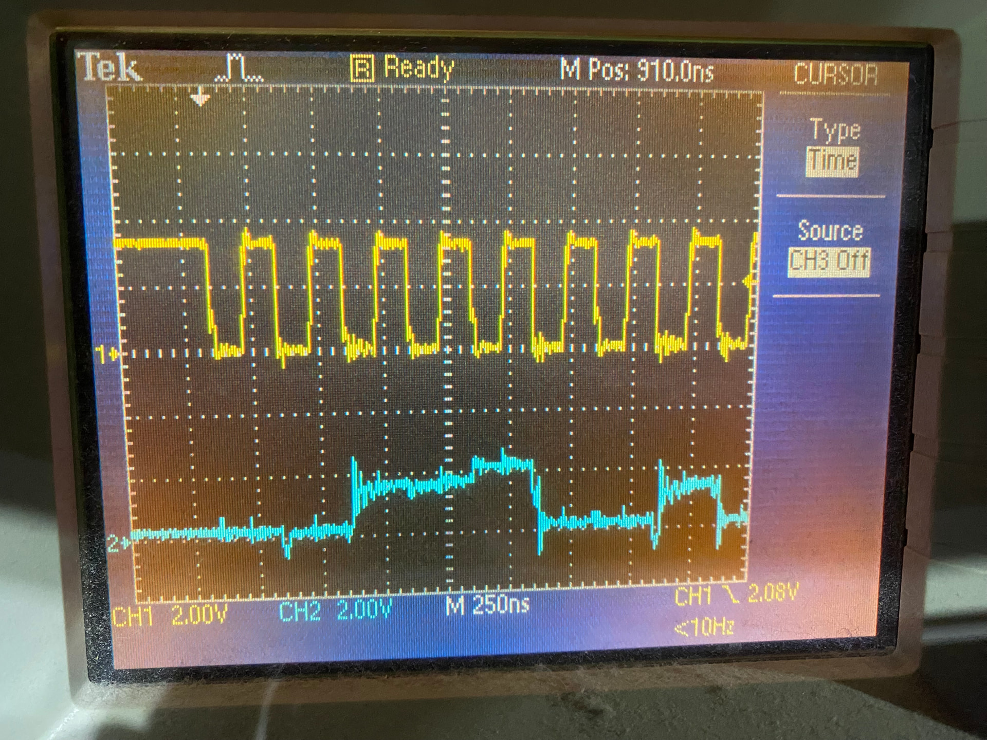

Just a follow up.
  • With spi running at 2000000 bps, the ADXL345 disconnected and the associated printer.cfg statements commented out - homing and movement work correctly.
  • With spi running at 2000000 bps, a short ADXL345 cable (25cm - 0.25m) and the ADXL345 printer.cfg statements restored - homing and movement work correctly.
  • With spi running at 2000000 bps, the long ADXL345 cable (220cm - 2.2m) and the ADXL345 printer.cfg statements restored - get the errors reported above.
  • With spi running at the default speed of 5000000 bps (I’m guessing this value based on the ADXL345 speed stated here: Configuration reference - Klipper documentation), a short ADXL345 cable (25cm - 0.25m) and the ADXL345 printer.cfg statements restored - homing and movement work correctly.

Now, I’ve just gone through all the schematics and your schematic snippet above for the level shifter implementation isn’t correct for SPI lines on the Manta M4P/M5P/M8P V1 boards (it appears to be the signals on the STEP pins and they’re pretty ugly waveforms). I’ll comment on Manta M8P V2 below.
When I look through the schematics for the selected boards, the SPI SCK and MOSI lines fan out to the steppers and the SD Card socket and the general purpose SPI connector. The lines going to the stepper drivers are redriven through CMOS buffers which raise their logic levels to 5V so there really isn’t anything controversial there.
The issue is when I look at the MISO lines on the selected boards. Going through the schematics, they all can be drawn out as:
I haven’t included the decoupling caps on the pull up resistors which may or may not be a factor in the line’s operation and I haven’t put the TVS diode on the 3.3V MISO line. Note that the Manta M8P only has one 10k pullup on the 3.3V MISO line while there are two on the other boards.
Regarding the Manta M8P V2, it has three SPI buses - one for the stepper motors, one for the SD Card slot and one for external devices. This is what I would consider the correct way to implement the SPI connections and should minimize/eliminate the issues I’m seeing here.
Going back to the other boards, MISO is held high unless one of the devices on either the 3.3V or 5V MISO lines are pulled low. There shouldn’t be a problem for the devices on the 3.3V MISO line (the SPI Connector ro the LCD Connector). But, for the stepper MISO lines, there are the pullups along with the capacitance of the line to the SPI Connector. This also includes the capacitance of the diode (which, for the IN5819W used on the Manta boards, is surprisingly high).
I suspect that if I were to look at the MISO signals provided by the stepper motors at the MCU using an oscilloscope, I would see a pretty distorted signal with the 2.2m long ADXL345 cable in place versus the 25cm cable where things work which would have a more reasonable signal.

I just took a look with an oscilloscope on what I’m calling the “3.3V MISO” and the “5V MISO” on the M4P and the “3.3V MISO” looks pretty bad when being driven high to low by the TMC2240s and I’m experiencing fairly regular Klipper crashes with just the (10x) 'scope probe on the line.
The probe has 12pF capacitance, which is interesting because when I did the capacitance calculation for the 2.2m cable to the ADXL345 it came out to 11.7pF. As I said, the input capacitance of the Diode between the 3.3V MISO and the 5V MISO buffer output is pretty high (about 12pF, according to one datasheet) so the STM32 is probably reading a “High” voltage value for a “Low” bit because the RC decay slope is pretty flat.
I’m looking at buffering the 3.3V MISO to see if I can get solid 'scope pictures.
Incidentally, I had another M4P that I set up by the oscilloscope and its behaviour is identical to the other board.
The conclusion that I’m reaching is that MISO circuitry is pretty marginal.
Okay, let’s close this off.
I built a little voltage follower board using an LM324 Op-Amp and powered by the M4P’s 3.3V line and used it to buffer the oscilloscope’s input.
The top line in the following images is the SPI Clock (SCK) and the lower one is what I’m calling the 3.3V MISO. Probing takes place at J58 which is “MCU_DISP_SPI1_EXP3” according to the schematic. Each 'scope picture was taken after executing manual_stepper stepper=stepper_0 enable=1 in the Mainsail Dashboard Console. Vertical deflection on the 'scope is 2V for both SCK and 3.3V MISO.
According to the datasheet, the STM32G0B1 (which is used on the M4P) is designed with a high threshold voltage of 1.9V (Vdd * 0.49 + 0.26V) and is tested at 2.3V (Vdd * 0.7).
The first image is the M4P with no ADXL345 attached to J58. The rise (on bits 2 to 5) on 3.3V MISO is surprising. Note that 3.3V MISO is consistently above the 2.0V line.
The next image is the M4P with an ADXL345 attached to J58 with a 25cm cable. Note that rise over time over bits 2 through 5 is no longer present and the highest value of 3.3V MISO is hovering around 2V and is always less than in the previous image.
Executing accelerometer_query returns valid & consistent values for X/Y/Z.
The final image is the M4P with an ADXL345 attached to J58 with a 2.2m (25cm) cable. Note that the 3.3V MISO signal starts well below 2V in both cases although rises to an acceptable level the longer the signal is high. Klipper crashes consistently when manual_stepper stepper=stepper_0 enable=1 executes
The conclusion is to not connect an ADXL345 (or any SPI device) to the J58 connector if stepper drivers with SPI communications is used with any of the stepper drivers.
