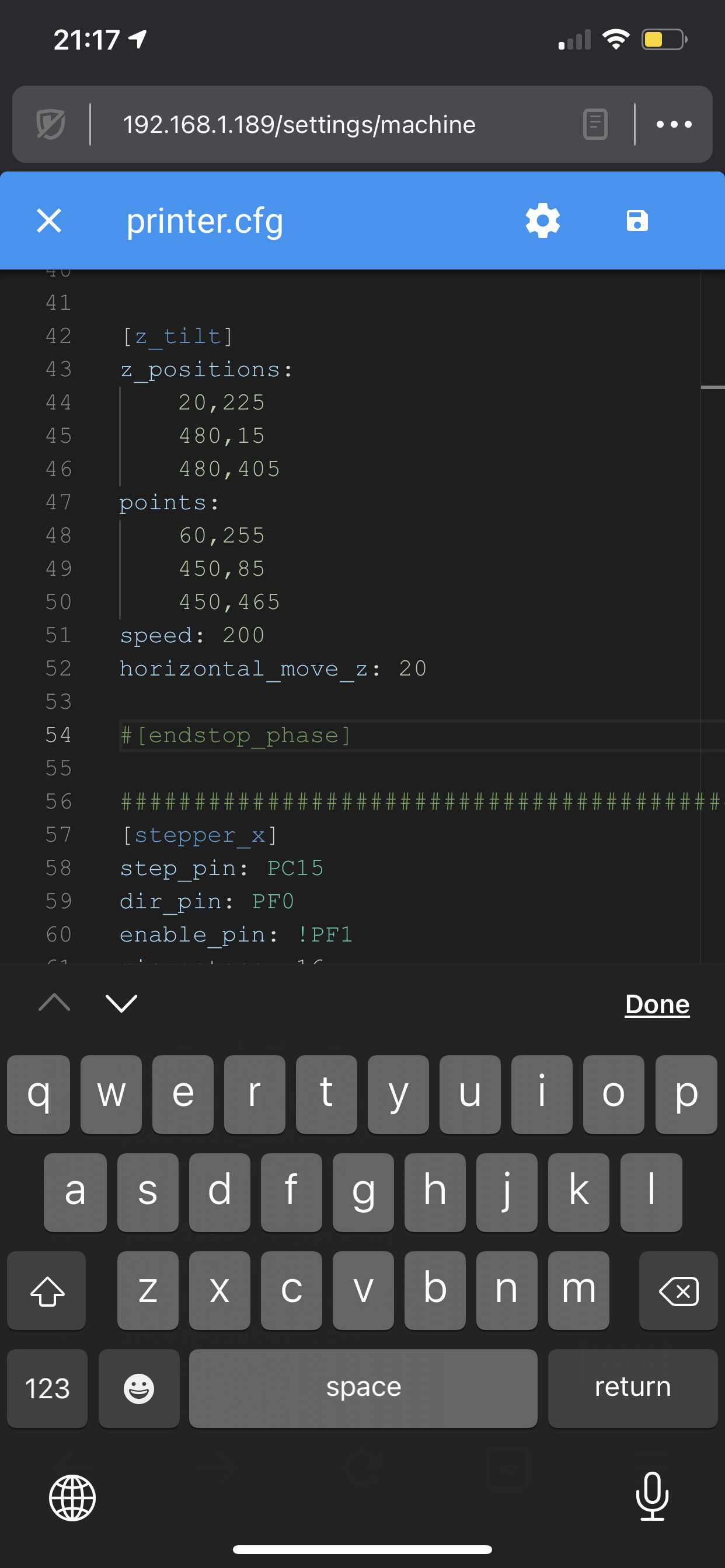

Hello all I have a corexy blvcube 500x500. Running it all is a gtr v1.0. With independent triple z. I have everything set up to home. But when I try and use z tilt it makes the bed worse than originally was. Here is my config. I have video of the issue but can’t post it here. Thanks for the help.
very likely the order you define the z positions is wrong. They must be in the same order as you define the Z motors. try to doublecheck that
