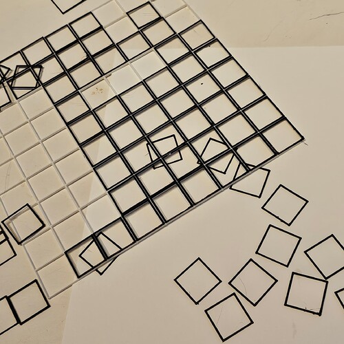

Array of Poor Corners
The new method uses the containers, which are in black, and a grid (white) to keep them firmly in place during painting. The white grid is then removed after the painting is completed, while the paint is still wet.
I would like to create super sharp corners, that’s the objective, while I’m here at this point in the development of the painting method. Then, from there, perhaps I will move on to other shapes.
I don’t know how you’d trick the slicer into doing it but now that I see the literal “bigger picture” what would probably make the corners a lot sharper is if it extruded the grid in lines and not tried to draw squares.
You know what I mean? Like extrude the entire column and row width.
But again, I don’t know how to force a slicer to do that. But you could honestly probably write some custom gcode for that since it’s such a simple shape. I don’t know how you’d custom write the extrusion though, you’d have to play around with that.

There is nothing in Klipper that sets any kind of corner radius. Klipper reads coordinates from the g-code file (as produced by common slicers) and moves the toolhead to those coordinates as best as it can.
Given the small scales you are working with, I’d guess that you are hitting the limits of the molten plastic. That is, it’s fundamentally difficult to deposit molten plastic through a nozzle such that it remains in a perfect 90 degree shape. Most people that require prints with surface details of that scale will utilize resin 3d printers.
It might be possible to improve the precision of your prints to the point that it meets your requirements while still using an FDM 3d printer. I don’t know of a hard “upper limit” on precision. To get to the next level, though, I’d guess that you’ll need to become an expert on the G-Code format, as I suspect using a typical cad program and typical slicer wont work. That is, I suspect you’ll need exquisite control of the actual coordinates sent to Klipper in order to get that type of fine control.
In particular, if you want a sharp corner, start by making sure the g-code contains a 90 degree angle at each corner (with no fillets of any kind). Once you’ve confirmed the gcode is requesting 90 degree corners, you can measure the deviation, and try to remove that deviation (eg, via pressure advance, velocity settings, or altering the corner coordinates in the g-code).

Thanks, koconnor. I read about the resin printing, but I think the design will not survive all the post-processing. The squares are very delicate, and there are 81 of them, in this case.
I’ve also read, over and over again, that the minimum achievable radius on FDM would be comparable to the nozzle radius.
Thus far, I am only able to get 5 times the nozzle radius. :neutral_face:
Have you used a needle gauge to check if your nozzle orifice is actually the diameter you think it is?
Another idea. When I design parts that I want to fit together with tight tolerances, I try as much as possible to avoid any corners of 90 degrees or less. Perhaps you could tweak the model to fillet or chamfer the corners very slightly so that you don’t need perfect 90-degree angles.

I checked the needles with my calipers, and the 0.15 mm needle went through, and the 0.25 mm needle did not, at all. My calipers were less than 0.05 mm maximum error.
My recollection is I did create fillets of 0.25 mm radius on the outside corners. This radius is the same width as the rails (so as to make a 90-degree corner), and the 0.25 mm radius of the corners are larger than the nozzle diameter. I planned this 0.25 mm dimension based on the width of the extrusion. Maybe there is more I can do in this regard, in terms of extrusion parameters. I almost completely forgot all the parameters and dimensions that I was using.

During which, I have since spoken with a friend who recommends just trying these 0.5 mm corners in order to get some paintings completed, and maybe try to work out the details with a paint brush, if needed.
The point of all this was to avoid touching up corners with a brush on 81 squares, because that’s 324 corners! Imagine a larger painting.

The photo below is the ‘grid inside grid’ prints that I will next attempt to transfer onto a prepared canvas, and continue with the encaustic and oil color painting technique.
[There is a small break visible on the lower right, but it doesn’t do anything. It just snapped into place like everything else.]
