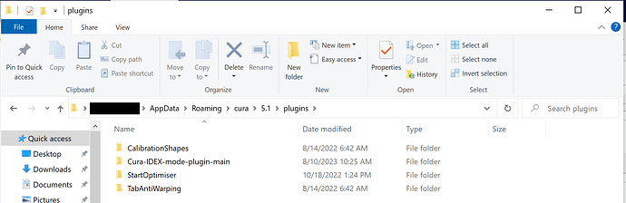

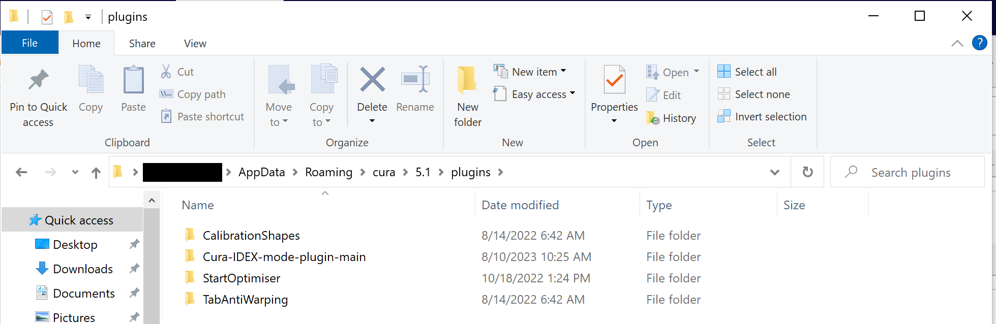

Okay, I’m really new to all of this - how do I install this plugin?
Download the files from github and put those extracted into a subfolder of Curas plugin folder:
C:\Users\[Your Username]\AppData\Roaming\cura\x.x\plugins
Just the two .json files?
The .json and .py files.
Just extract everything before it makes a mess otherwise.
Ah. Looks like I’m going to have to learn how to work in Python (I know nothing about it). If I get time, I’ll be trying to see how it works in 5.5 beta, but I’m having issues just getting my second extruder to work.
You don’t need to know anything about python. Just open cura then click Help>Show Configuration Folder and open the plugins folder that is located there.
Drag the whole IDEX-mode plugin folder into that plugins folder.
That is all that is required to install the plugin.
All the plugin does is include the name of the selected mode in the gcode when it is generated. (and resize the preview build plate if you have the option selected)
