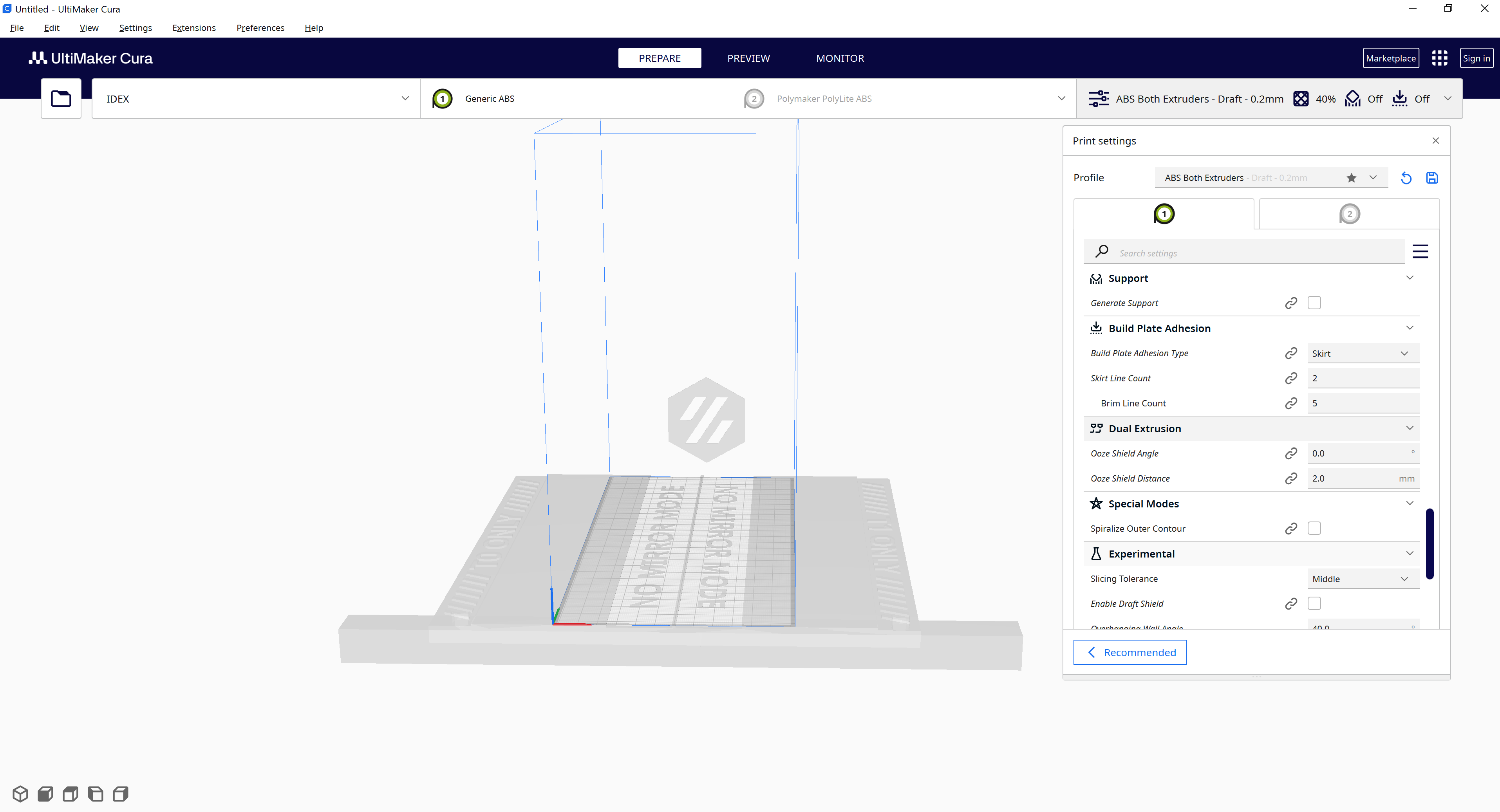

I don’t have time for any real testing right now. I just installed the new plugin and did enough to get this pic, but it appears restricting the Dual Extrusion options for single nozzle printers seems to work correctly for single nozzle printers, but for IDEX machines I now only have options for ooze shield angle and ooze shield Distance showing. Despite being checked to make them visible, no other options are showing, not even the IDEX mode. This is visible in the above pic. What are you using to flag a machine as idex or single nozzle?
Noticed that the second extruder was disabled. Enabling both added enable draft shield and enable ooze shield, but still missing the rest of the options. IDEX mode doesn’t show up in the list of available options to make visible. This is in Cura 5.4
Ahhh, a picture says more than 1000 words.
Had this set up on my big CoreXY once… But currently I do not know how Cura handles this and if I can move this platform to the left.
That is something to work on.

I got a minute to try it in 5.1 and that worked fine. So I deleted and replaced it in 5.4. This time when I opened Cura there was a pop-up informing me that settings had been updated. Anyways it worked after that. I get the pop-up about settings being updated every time I open Cura 5.4 so something is still quirky about it.
EDIT: adapt bed width is there. I just had to check the box to make it visible.
