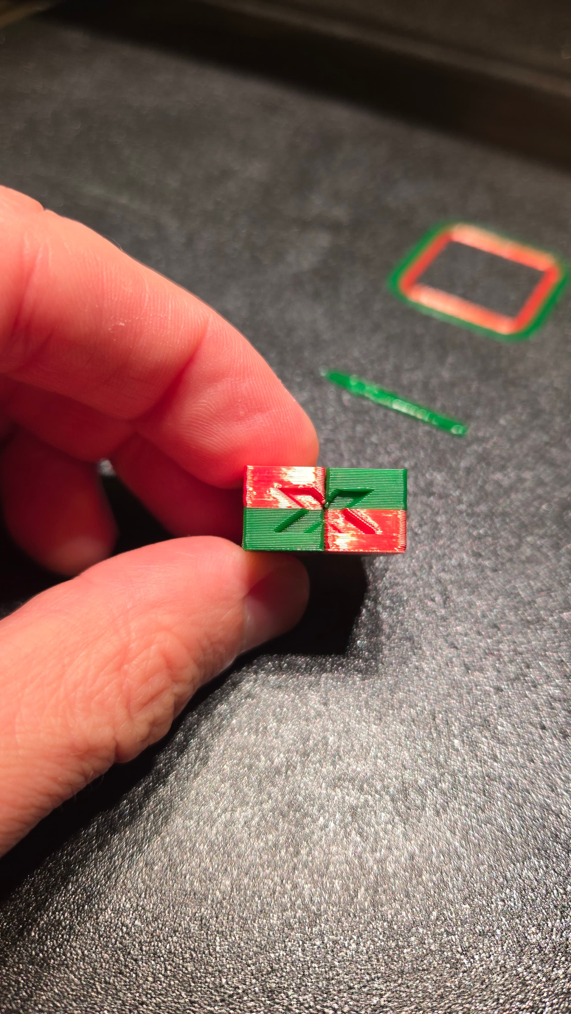

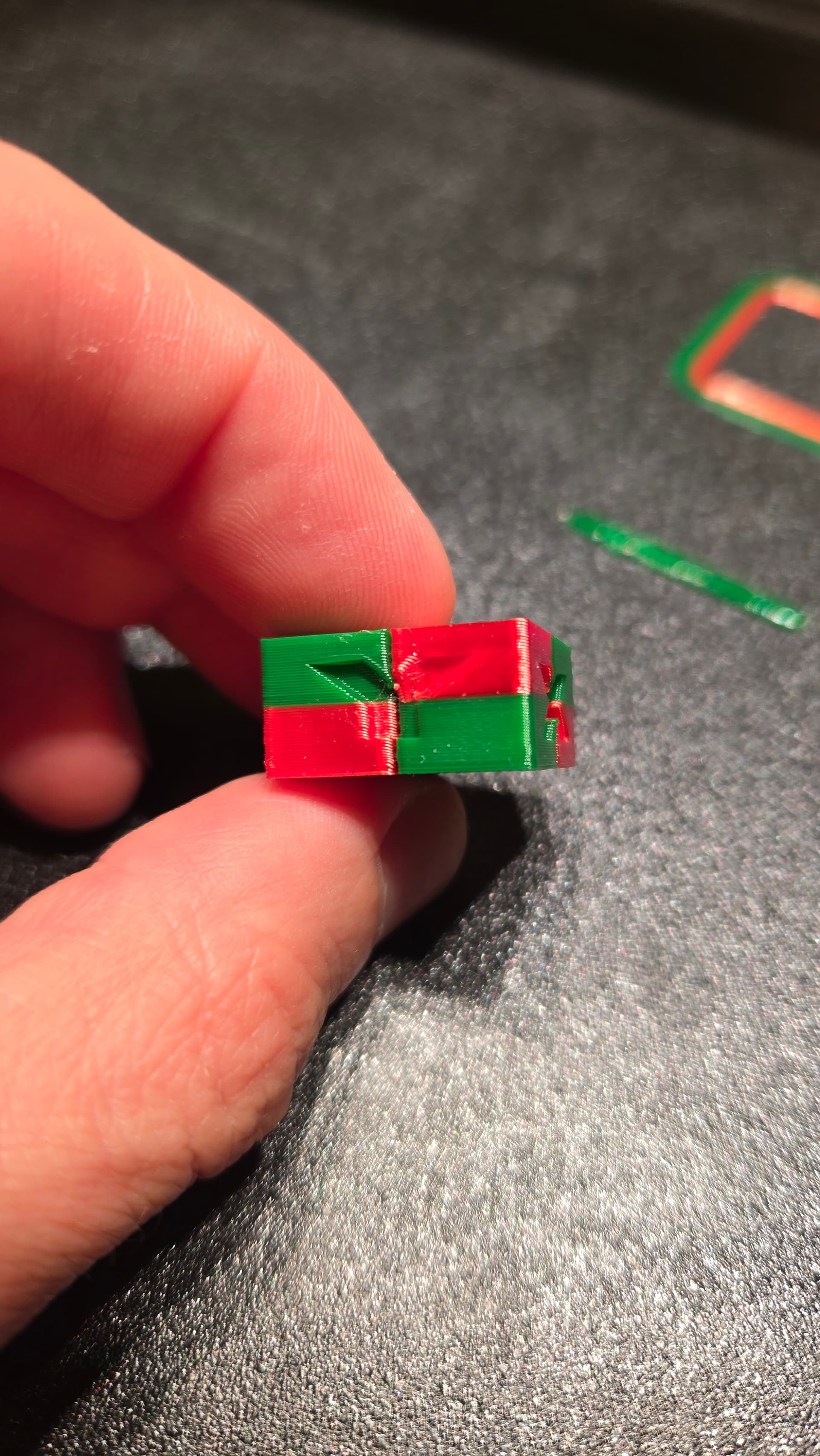

And an example of the fast tool swaps that become possible with this code (FWIW, RatOS also supports similar swap, but through quite a bit more complex compound motion, involving partial COPY/MIRROR mode moves):
And the resulting cube (the print time of the cube itself without bed and initial tool heating was ~8 minutes):
In case you want to reproduce it on your IDEX setup and test it, here’s how I did it. Note that it is fairly complex (including a need to override G1 command), but this is primarily because of lack of a proper slicer support (e.g. inability to get the next GCode position in slicing). Also the code not only swaps the tools, but also gradually cools down inactive tool to prevent the filament from cooking there, and as a result the tool swapping code supports both fast swaps (when the other tool is not cooled down too much yet) and slow code swap (waiting the other tool to heat up).
