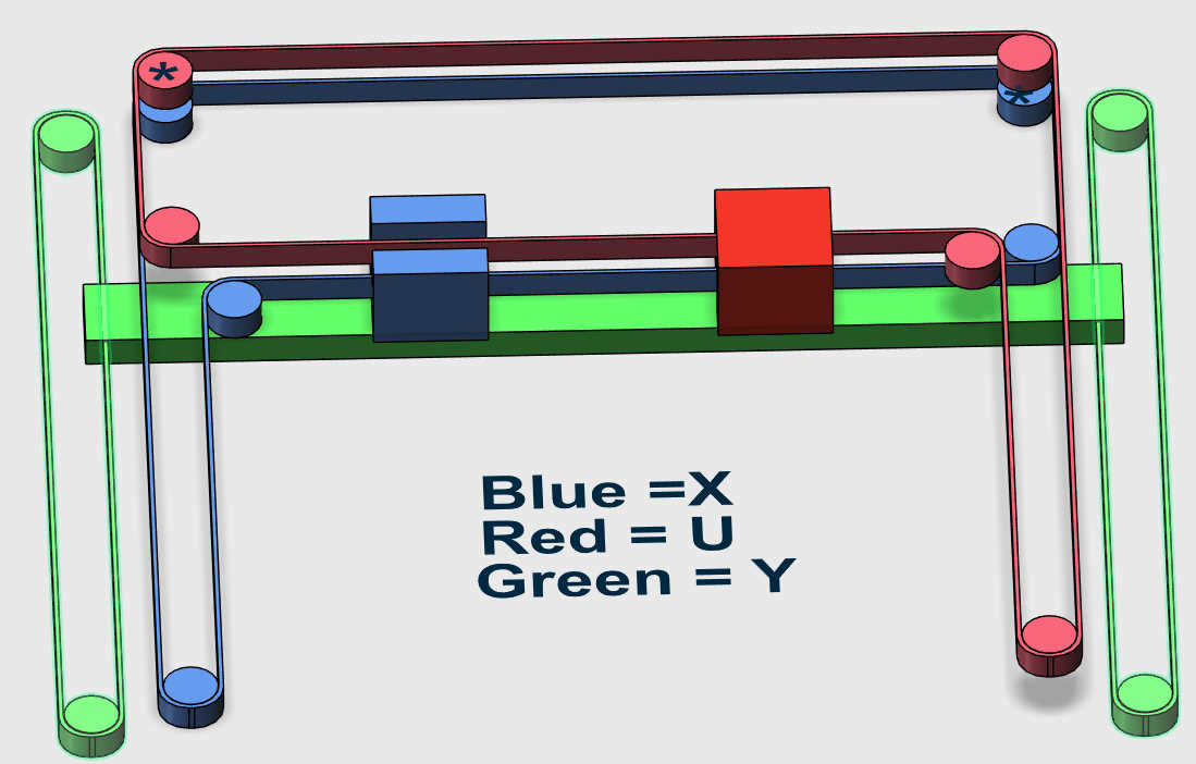

My IDEX design I call CoreIDX as it started life as a CoreXY. Very minimal changes to the hardware design. Pretty much just added a second carriage/hotend (U) and separated the existing belts, attaching one belt to each carriage. The belt change means a Y drive must be added to move the gantry forward and back. This approach retains most all the advantages of the CoreXY design of low mass and belt tension maintained gantry alignment. I built this on a HEVO frame but the concept could be applied to just about any CoreXY machine, with the caveat of the kinematic requirements. If I still have your interest I will be releasing my printer on Thingiverse soon and more can be found with a Goggle search on CoreIDX.

Here are how I compare CoreXY and my Core IDX
If you look at the Bottom Core IDX image, there are (*) on two pulleys. Those are the two pulleys that have moved off the gantry of the Dual Mark Forge image you provided to the opposite rear corners of the machine frame. This change provides significant gantry alignment stability just like a CoreXY printer.

OK, I may have misunderstood the format of M669 command. If the picture below describes your printer, then it does seem like it is a hybrid_corexy kinematics with [dual_carriage], which is something that is directly supported by Klipper today. You can check out the relevant documentation in Klipper:

As I said, I misunderstood the representation for M669 command, therefore I posted earlier the transposed version of the matrix. Basically, with hybrid_corexy kinematics Klipper supports the following:
stepper_x = x - y
stepper_y = y
stepper_z = z
stepper_u = x + y
where x, y, z are cartesian coordinates, and stepper_x/y/z/u - printer steppers. Klipper does not support ‘u’ coordinate natively, but it allows to switch between the carriages, so that inactive carriage remains still and the active carriage gets gcode ‘x’ as its ‘x’ coordinate (so for dual_carriage gcode x gets mapped to u). Hope that helps.
