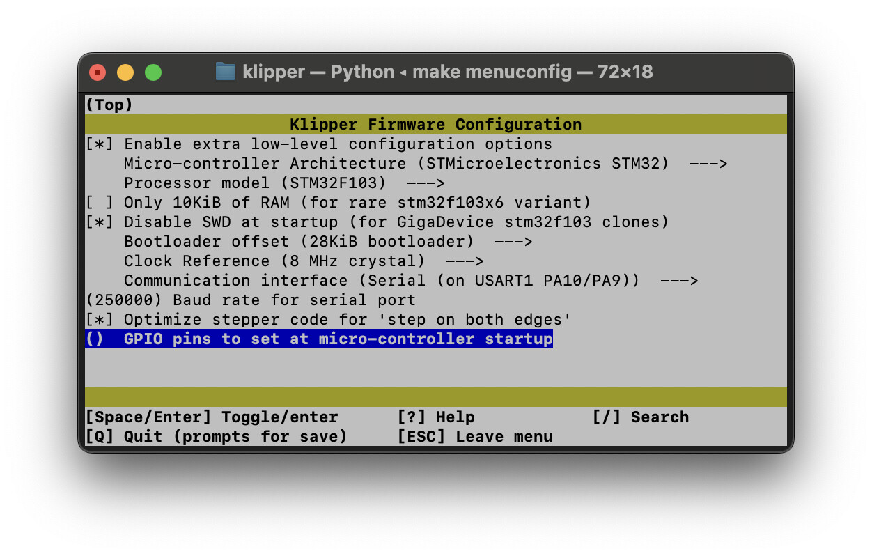

I’ve been trying to flash Klipper firmware on my printer, which uses a Creality 4.2.2 board, but I haven’t had any success using the settings shown in the image:
I’m using an 8GB Kingston SD card formatted to FAT32 with the SD Card Formatter tool. This same card has successfully flashed Marlin firmware before.
For Klipper, I renamed the klipper.bin file to something different than the previous firmware (to avoid booting issues), but the board still doesn’t flash. I’ve also tried different bootloader offsets (8KiB and 64KiB) during formatting with no luck.
The compiled .bin file is about 35KB — not sure if that’s expected or if something’s going wrong during compilation. I’m running out of ideas at this point.
If someone could help by compiling the firmware for me (just to rule out any issues on my end), I’d really appreciate it.

As for make menuconfig, I selected:
  • STM32F103
  • 28KiB bootloader (I also tried 8KiB to be sure)
  • USB (on PA11/PA12) for communication
I don’t have a full schematic of the 4.2.2 board, if it help I could send a picture of the full board, I’d be very interested in your suggestion about toggling an onboard LED to verify Klipper is running. If you can guide me on how to configure that in the firmware, I’m happy to give it a shot.

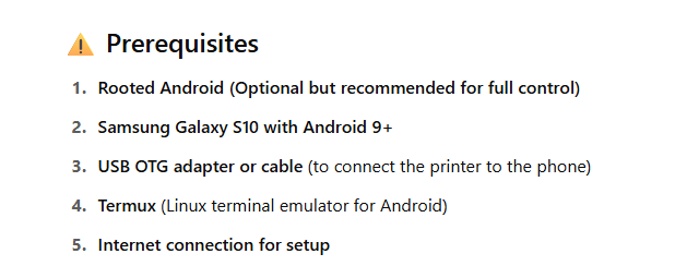

I’m not familiar with the “Samsung S10” that you listed as your host - when I do a search on it, it comes up as a smartphone. Is this what you want to use as your host? Is this what you’re trying to connect to?
If it is, could I suggest that you look at something like a Raspberry Pi 4B as your host? It works very well with Klipper and most of the Klipper documentation and examples use it for reference.
I couldn’t find a guide to running Klipper on an S10 - so for feces and giggles I tried ChatGPT and it starts with:
I’m not sure you want to root your phone on the recommendation of an AI.
I’m thinking that maybe you didn’t have any issues with building and Flashing Klipper onto your Ender 3 4.2.2 board - it’s just that your phone wasn’t set up properly to access the USB connection.
I highly recommend that you buy yourself a Raspberry Pi and go through the Klipper set up for the Ender 3 as is given in the link above.

[mcu]
serial = /dev/serial/by-id/<your-mcu-id>
