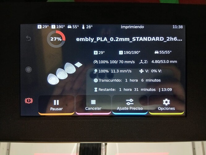

Error when calculating estimated time in idex printer when T1 is active
Printer Model: Custom
MCU / Printerboard: Manta M8P
Host / SBC CB1
klippy (6).zip (5.5 MB)
I dont’t know why, maybe it is my fault or maybe it is klipper/mainsail/klipperscreen but my estimated time doesn’t work when i print with T1.
I atach some photos so you can see:
I atach too my T1 macro so you can take a look and know if these are the responsible to make it doesnt work:
