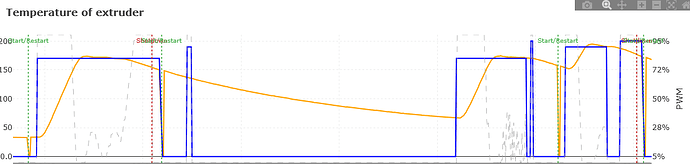

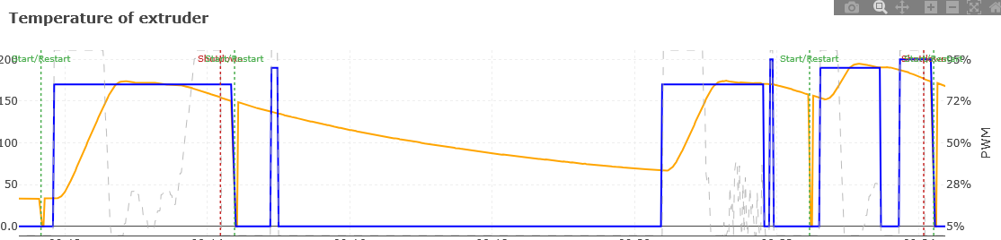

My temperature control isn’t working correctly.
I recently converted my Kobra 2 to Klipper, but when I use the temperature control on the dashboard (Mainsail) or with the command:
SET_HEATER_TEMPERATURE HEATER=extruder TARGET=190
the temperature doesn’t change. However, when I use a custom macro for testing the heating, it works fine:
[gcode_macro test_heating_hotend]
    M80
	M104 S190
    m109 S190
    M81
Do you have any ideas about this? Did I misconfigure something?"

It appears that, once the hotend reached it’s temperature, it looses connection and does not heat any more until it reaches some certain lower temperature.
The can be an issue withe the heater cartridge or the controlling MOSFET.
This is maybe due to you used the first command when the hotend was hot and the second one when it was cold.

Thank you for your reply.
I made the macros for testing the theory about the command. I can run the macro even if the hotend is already hot. I also tried a new heater, but I got the same issues.
With the default firmware, it works properly.
(I changed the typo in the macro thanks to you.)
I have the same issue with the bed heating, and with the custom macro, I can also heat it.
