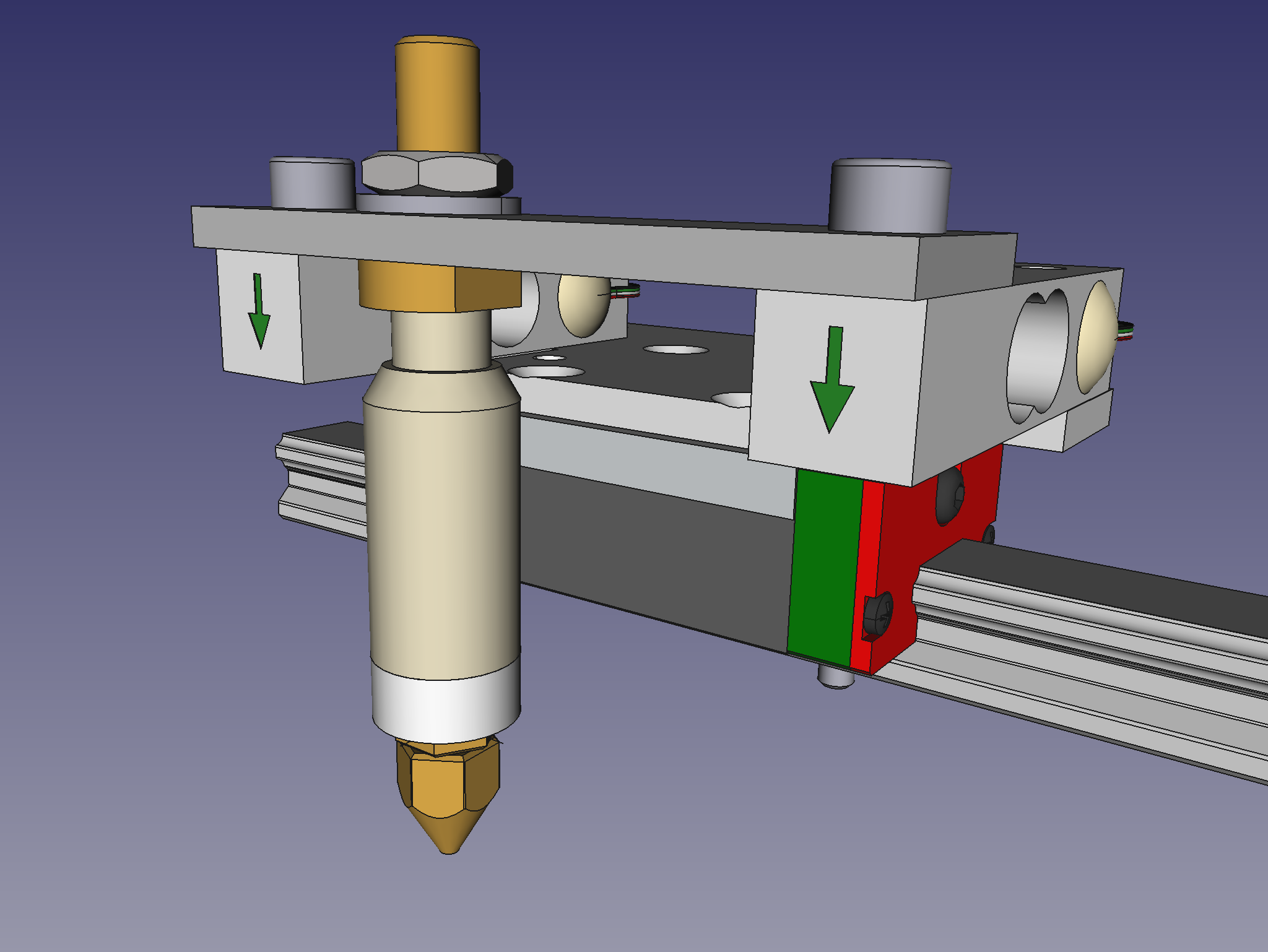

Here is a (partial) rendering from a CAD model of my printer:
The two bars with the green arrow on the front are the load cells (type TAL220B). They are mounted on the X carriage of the guild rail. At the other end of the load cells, there is a metal sheet traverse, at which the hotend is suspended. Electrically, the two load cells are connected in parallel to e.g. a HX711.
You can find a full 3D model (FreeCAD) of my printer here:
You can probably also chose smaller load cells, if space is limited. Just make sure they can take the extrusion forces and do not bend too much (otherwise print quality will suffer).
