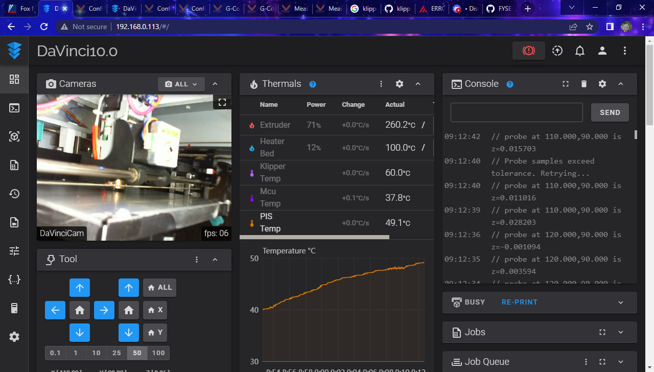

I want to mount it lower in this area
When its not accelerating, I have it configured to be a Chamber Temp monitor

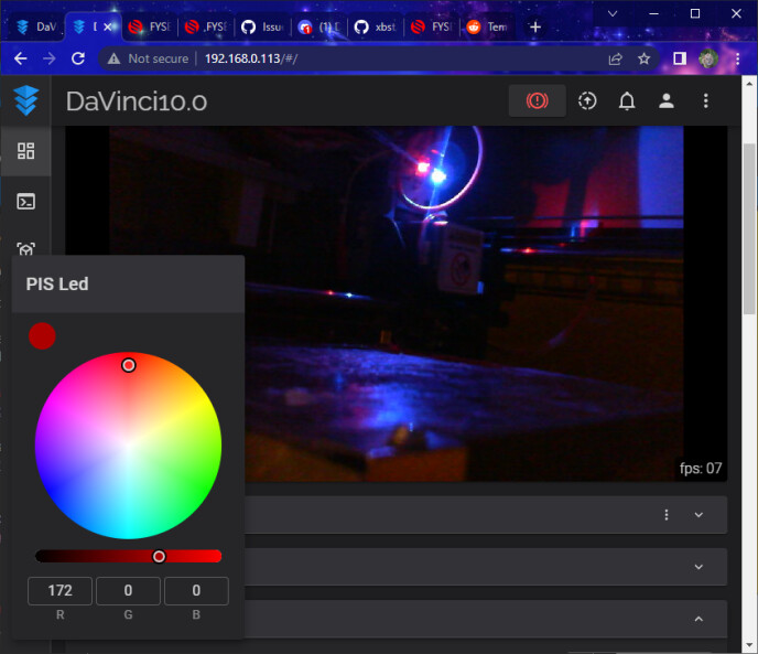

As well using the Red LED Indicator for hotend temps during warmup… :slight_smile:
edit: oh I should of posted the pic of the real reason to get it…
