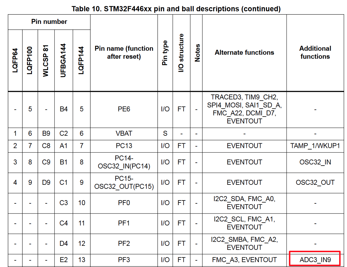

in the desciptions on thingiverse and Printables they use RX/TX pins for sensor connection on SKR 1.4 but on Octoboard I get the error this are no valid ADC pins - I think the stepper-dirver-pins should have an ADC-pin also? I didn’t found the ID’s for this singe pins… would be great to get back my termistor pins ~~
Get the datasheet of your printerboard’s chip, e.g. https://www.st.com/resource/en/datasheet/stm32f446ze.pdf
There you will find a table with the pins functions, e.g.
For any one reading this: DO NOT do this before carefully checking your boards capability. In fact most pins only tolerate 3.3V and putting them to 5V may damage your board.
