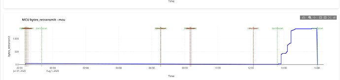

I have looked at the klipper.log in the “klippylyzer” and “visualizer”. And the crash is right at the beginning of the log. Klipper crashes right in the middle of sending an status update. Then takes up again with “Staring klippy…”

I took the bed heater controller out of the circuit entirely and the bed is now powered directly from the SKR Mini E3. Now the only lines from the PSU is to the SKR. Not a fix. I am seeing high re-transmit during the print. Is that indicative of a problem?
According to your log:
  • Klipper seems to be spontaneously restarted, which likely points to an unstable SBC that might either be hard crashing or the Klipper service is crashing. Try journalctl -u klipper.service -n 50 --no-pager right after the event.
  • It contains a “Transition to shutdown state: Lost communication with MCU ‘mcu’”, which also points to hardware instabilities. See Timeout with MCU / Lost communication with MCU
