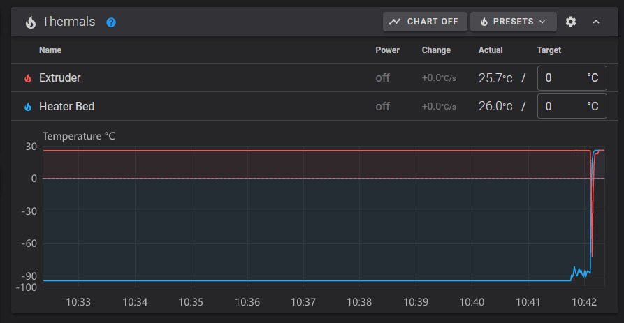

When reading ambient tempature of extruder and bed on the MiniRambo 1.3a on the Pulse XE i get a reading of about 4 degrees higher then on the SKR mini E3 V3.
the right tempature is the one i get from the SKR.
thermistors and configuration are identical.
i can’t understand why it happens.
Have you checked putting them on the exact same place and the exact same thermal conditions?
Even with a slight breeze at another place, temperatures can change.
Just curious:
Besides the time scale, the graphs look very identical.
the measuring took place in a 5 minute diff and from the same printer (the 5 minutes is the time i needed to disconnect the SKR board and plug in the Rambo.
i have attached the thermistor schematics for both boards, maybe it will give someone an idea :slight_smile:
SKR Mini E3 V3
Rambo 1.3a
Yo!
That really can make a difference.
Any ideas as to how to fix it?
The question is: How precise are the measurments at the heat up temperatures?
But maybe you can adjust a bit with varying the pullup_resistor and/or inline_resistor values in the printer.cfg
