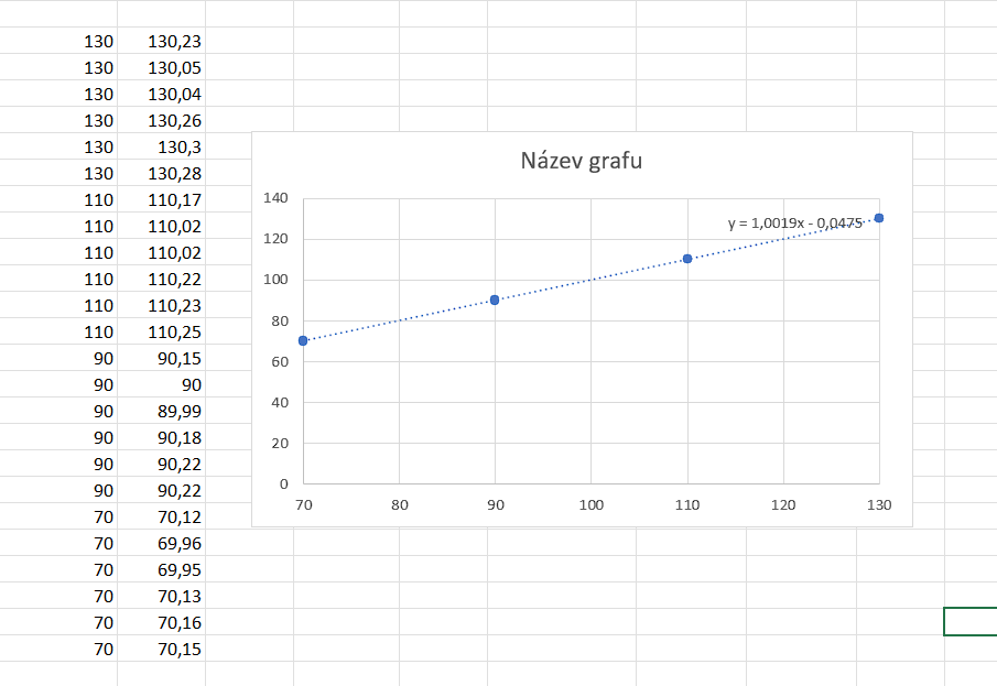

Inconsistent X distance measured
Your absolute error is NOT related to distance traversed but looks to me to be 90% hysteresis.
The extra load of having to pull the caliper along is probably causing half of it.
What type of printer?
Is the fixed end of the caliper anchored to the bed, upright or X axis rail?
Plot all your data. Target distance on the X axis, actual distance on the Y. Add a trend line and then display the equation. The X coeficent is your linear error (1.005 would be 0.5%).
So it looks like 0.19%?

Yes 0.19%… however your number of data points is not sufficient to support 5 significant figures so the correct interpretation is “no measurable error” and get back to printing.

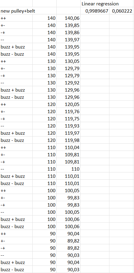

Hi guys.
To finish this thing, I finally got the new belt + pulley and installed them.
I did new measuring, and it’s better with it :slight_smile:
Here are measured values and linear regression over all data:
Here are data sorted by move type and regression only on one move type:
Few interesting things:
Doing ++ ends with correct length and static error around 0,05mm
Doing - - ends, for some reason, with biggest error. I would expect same result as ++.
Overall the error is so small that I will not change anything :slight_smile:
