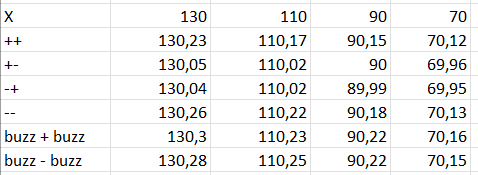

I wanted to check X distance traveled by the printer, so I attached caliper firmly on the X gantry and tool head.
Then I use command FORCE_MOVE stepper=stepper_x VELOCITY=10 DISTANCE=130 to travel 130mm with low speed (to prevent “overshot”). I use force move because the caliper is not long enough to home the axis and I want to do the move in the middle of the X axis.
But I found, that I measure different distance depending on the move direction and depending on the move before/after the 130mm move.
I checked the X axis, everything is tight (motor, pulleys, belt…), belt tension doesn’t have effect to it also.
Only result which is pretty constant and pretty same in both direction is, when I do before and after the move STEPPER_BUZZ.
Here are my measuring (ZC = Zero the caliper).
move +10 → ZC → move +130 = 130,34 mm
move +10 → ZC → move -130 = 130,11 mm
move -10 → ZC → move +130 = 130,12 mm
move -10 → ZC → move -130 = 130,22 mm
buzz → ZC → move +130 → buzz = 130,26 mm
buzz → ZC → move -130 → buzz = 130,25 mm
The 130mm move is always on the same part of the X axis.
Is this normal? It looks like some belt elasticity or something like this.
Thanks for any hints.

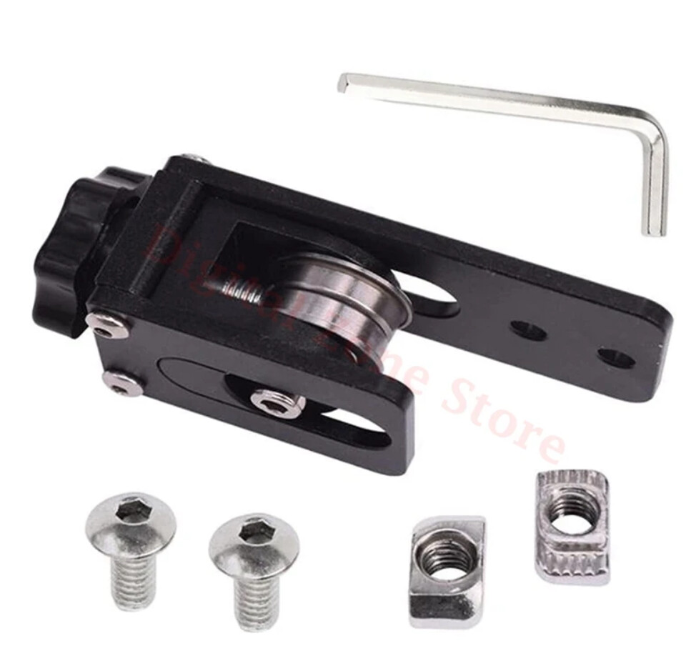

Pulley on motor is tight. Only thing which has little clearance (if it’s the right word) it the pulley on the tightening mechanism. But when I try to move with it by hand, it doesn’t change the measuring, but I will try to do something to tight it up. I use this one:
What acceleration do you use for the tests?
I tried to replace the tensioner with the original one. It doesn’t have the nice hand mechanism, but it’s rigid. The result is the same.

What are your results at 65mm? There are 2 primary error sources; 1) the radius of the belt sprocket 2) mechanical hysteresis.
If you make measurements at say 70, 90, 110, and 130 mm and do a linear regression of the error you’ll find that “m” is the systematic error that can be corrected by changing your rotation distance. The “b” is the mechanical hysteresis which is impossible to fully remove.
Note: the drag of your measuring system will cause MORE hysteresis than actually exists when printing.

Thanks for replies.
I made measurement with 3 other distances:
