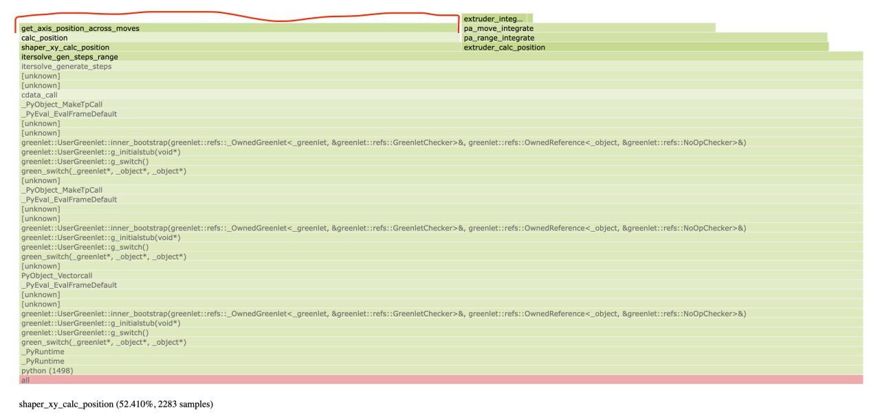

the limitation is going to be in the C step compression code
step_compress is limited from above, for 65k steps. So large amount of steps (high microstepping) and movements should just increase amount of output compressed steps.
For many small arcs, however, it’ll likely start to stress the host CPU’s ability to run the Python code.
Python is pretty fast, most CPU time is spent in C.
I’m with a friend of mine, spent some time benchmarking it. as one of the fruits of this was my patch-to-arc generator. This was simplest part :smiley:
(we actually tested it with a resolution of 0.025 and really large arcs with a radius of 150mm)
To be precise, on perf data most of the time is spend in:
static inline double get_axis_position_across_moves(struct move *m, int axis, double time)
and
static double pa_range_integrate(struct move *m, double move_time , struct list_head *pa_list, double hst)
But, this happens not because the list travels slowly or something to my surprise.
The issue is here:
static int32_t
itersolve_gen_steps_range(struct stepper_kinematics *sk, struct move *m
                          , double abs_start, double abs_end)
Because of a lot of small moves, it can iterate 1000-3000 times on the same path, till it finds what it wants, and all lists and large amount of small movements make it only worse because at the above functions it will iterate every time from a fresh start.
we did come up with a dirty patch, which fixed this by caching the last move entry position.
But because it dirty and original author does not have time to refactor it - is still not in PR :smiley:
Before patch
After patch
o
AFAIK from our testing, this gets x3 difference (really huge, we expect like 20% as a win), but it only caches for get_axis_position_across_moves. So, pa_range_integrate caching part is missing, this branch is next one by CPU usage in such cases.
normal “USB” mode is due to the goofy “gs_usb” protocol …
Wow :fire: that is interesting
I’m not sure what tools you used to benchmark the code. Be aware that some tools modify the code to gather usage statistics, and these tools can dramatically alter the relative performance of the programs themselves. They can therefore provide misleading results. I typically measure performance using the LInux perf tool to avoid those issues. I’m surprised the C code was so much higher than the Python code - though I’m not surprised that the itersolve and step compression code are heavy consumers of CPU time.
Yeah - the itersolve system currently resets its predictions at the start of every gcode move. It’s difficult to make predictions across moves though because we expect each gcode move to change the pattern of steps. (Putting aside extreme cases like over-specified arcs, the purpose of each new gcode move is to alter the pattern of toolhead movement…)
