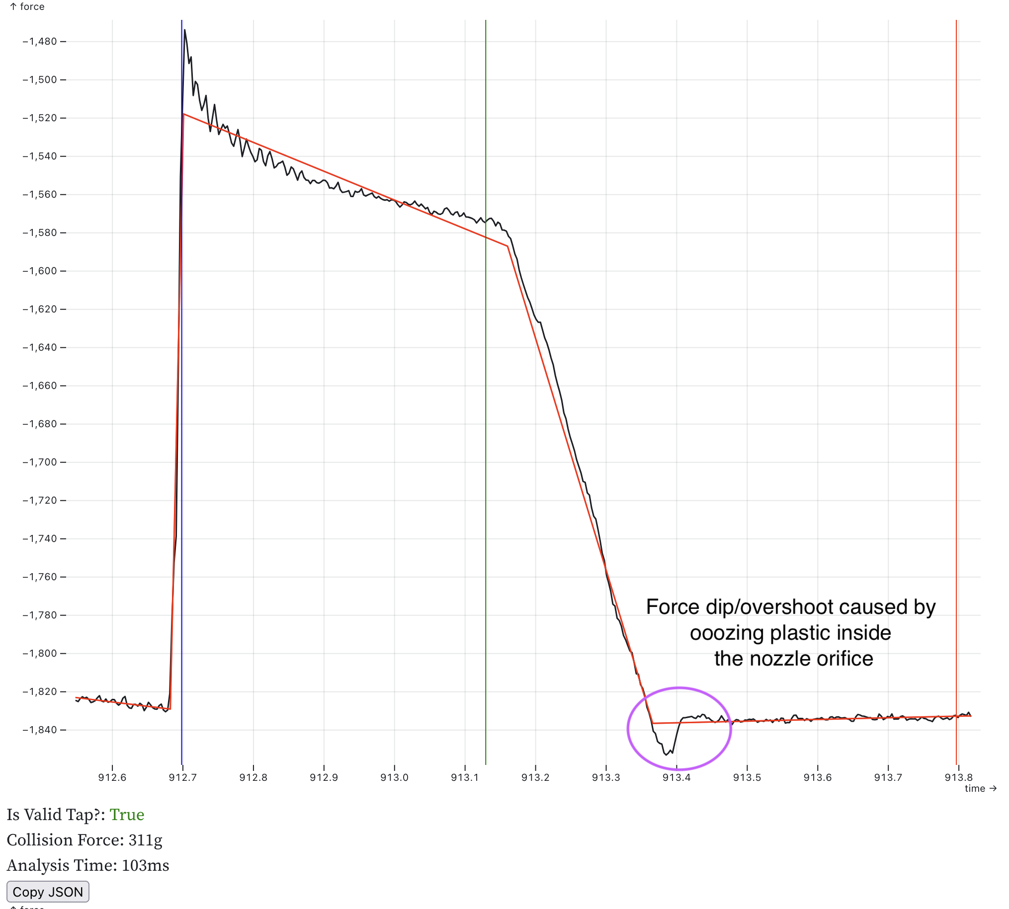

Here are some examples of things it can detect:
Major plastic fouling of the nozzle:
Build sheet not making firm contact with heater bed:
It detects this but perhaps this should be allowed (too aggressive)
It cant see this case where there is minor plastic adhesion in the nozzle orifice:
