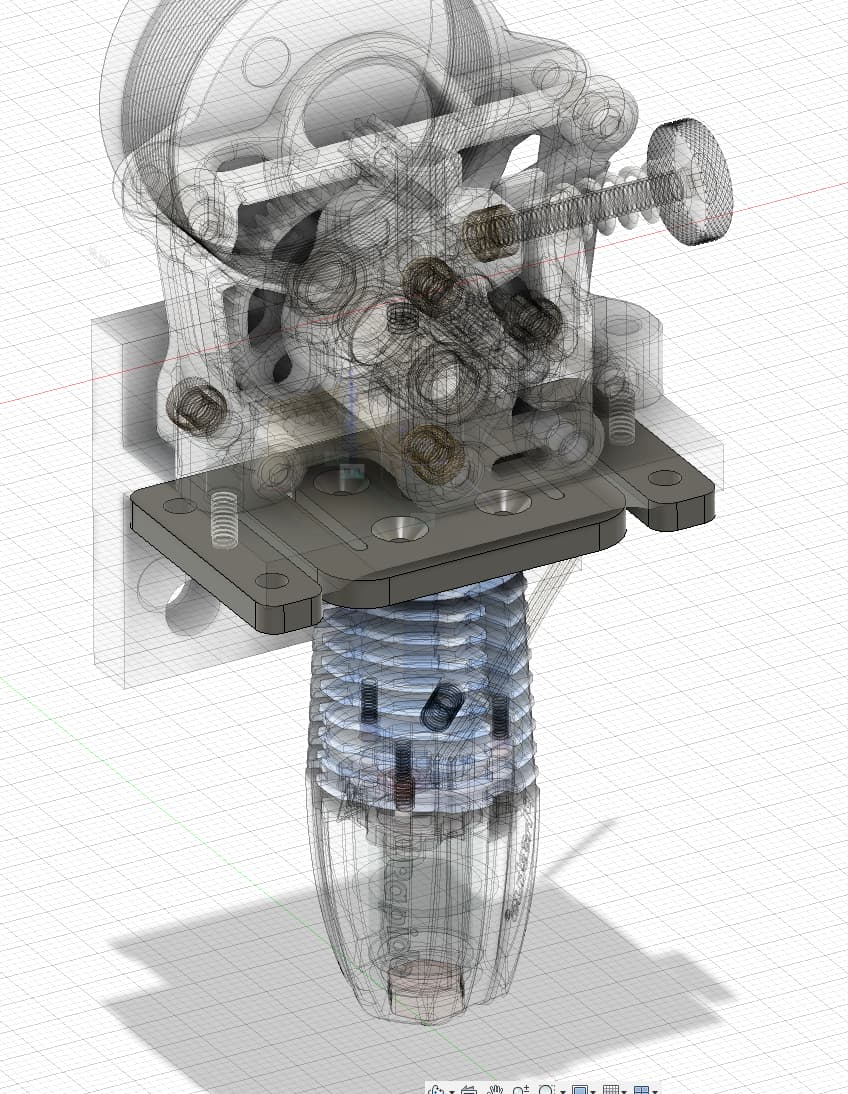

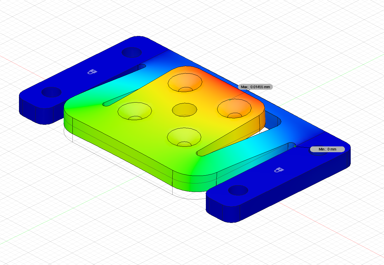

My custom Rapido heat sink is mounted to the underside of the tongue. You could also mount the standard Rapido (or other brand) heat sink in the same fashion.
very flat, light and does not take much space between hotend and extruder
could be made by laser
Cons:
forces modify the hotend position and angle (if only one plate). This could potentially influence the zero point of the hotend nozzle dependent on the extruder force in y-position. Could be negliglible dependent on the resolution of the strain gauges

It’s a parallelogram, the bottom is a solid arm, so it holds most of the load, maybe 80% (10Kg). The top has the flexure cut into it, so it holds less of the load (2Kg). The result is that you have to bend the bottom arm to deform the loadcell. But the entire structure can sustain higher loads than the flexure alone can.
