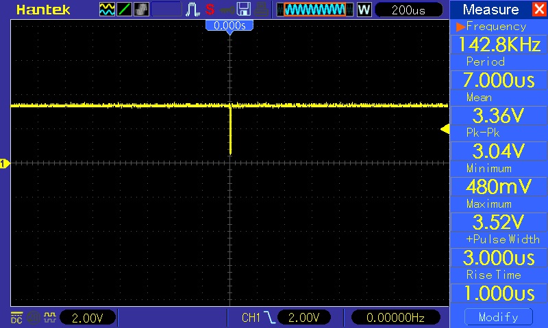

One thing I just realized I should have asked @borysne - what is the trigger level on your oscilloscope you’re using for probing PB6/PB7? Looking at the latest screen shot:
It looks like you’re waiting for a rising edge at 3.6V when you should be looking for a falling edge at something less than 3.3V.
Maybe things are working, but if the trigger isn’t set properly, then we can’t see them.

  1. I learned to use an oscilloscope)))
  2. I saw a signal on the SCL pin
And this means that from the software side everything works!) it turns out that the capacitor is the problem
There is a voltage drop during the calibration of the eddy chip

And now we were able to measure the frequency
I remind you that these are measurements without a capacitor! But with 1kOhm resistors

What does the I2C waveform look like on the PB6 line compared to the PB7?
I didn’t measure it PB7! only PB6 - SCL
what does this give us? the scheme is the same!
If you put the two waveforms together on the oscilloscope, like you did above, you’d see if there actually was a capacitor on PB6.

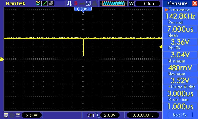

and so I removed the 1k resistors and put jumpers!
the problem remains
measurements by lines:
SCL
SDA
You obviously still have a capacitor on SDA.
I can’t give you any advice other than go through the board with your microscope and your DMM set to check continuity.
When you do your oscilloscope shots in the future, please include both SDA and SCL - it will be important when we’re checking the EDDY Coil communications.
