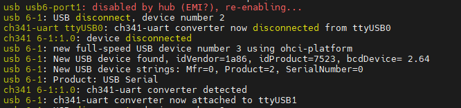

Hi , first time poster ,i am a beginner for 3d printing. i suffered a error after building my first printer .
my printer randomly shutdown during print. i have already check the power to pi and board, so i dont think that’s a power problem. i also changed the cables between board and pi but nothing happend , error still .
So could it be a mainboard problem? should i changed a new one? please help me.
mainboard:MKS Genl V2.1
PI : orangepi zero
here is the log , thanks in advance.
klippy (2).log (2.0 MB)
here is the dmesg

i solved it problem by using uart to connect mainboard and orangepi.
the error was caused by the inherent defect of mks genl v2.1 , the design of this board do not support high rate communication by usb.
Is this your finding or do you have any reference to this?
do not have any literally reference, I figure it out with some people, after changing into uart connect ion rather usb , this error never happened again.
I have tested two brand new board, sadly they all have the same issue , both works well after using uart
