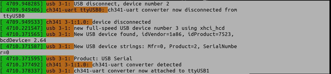

Random Usb detachment
Printer Model: Longer lk 4 pro
MCU / Printerboard: LGT_KIT_V1
printer (5).cfg (2.9 KB)
Fill out above information and in all cases attach your klippy.log file. Pasting your printer.cfg is not needed
Absolutely random detachment, i can “fix” it by restarting klipper then it lost connection with MCU
In dmesg you see brltty?
No.
I use Lubuntu and there is no brltty as i can see
copy full dmesg to https://pastebin.com/ and post link
