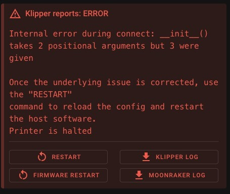

i’ve been running into the klipper issue after the probe changes to klipper from 10.jun24
Internal error during connect: init() takes exactly 2 arguments (3 given)
and found @cloakedcode fix to it…
the issue is that i still used the original annex probe from mental and now i run into the issue that my config still had dock_fixed_z: True and allow_delayed_detach: false these two again failed then…

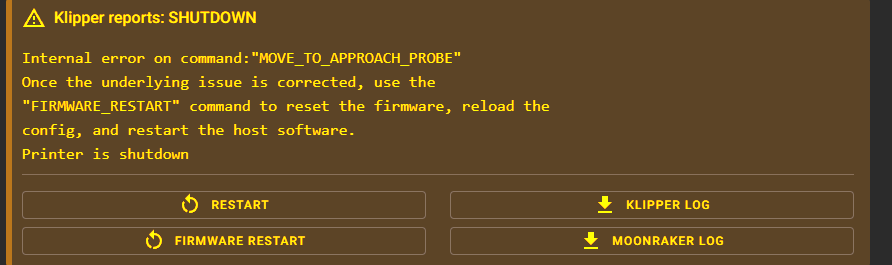

after disabling these two settings, klipper would start but now on QGL is failing:
Internal error on command:“MOVE_TO_APPROACH_PROBE”
Once the underlying issue is corrected, use the
“FIRMWARE_RESTART” command to reset the firmware, reload the
config, and restart the host software.
Printer is shutdown
this is the log snipped what happens in klippy log… sadly i’m nowhere near ah dev. to understand whats happening … :frowning:
Internal error on commandMOVE_TO_AP.txt (57.1 KB)
