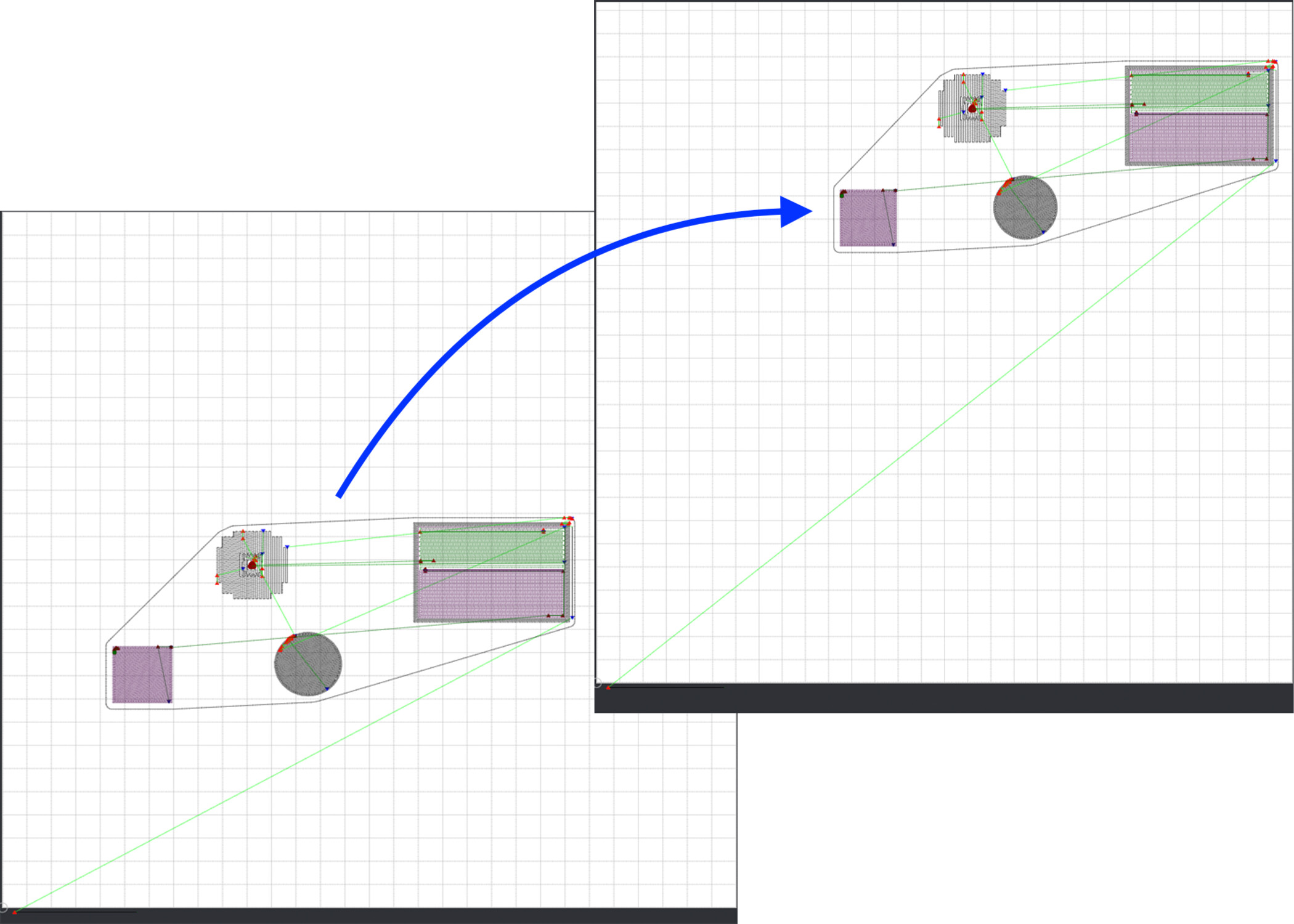

Is there a script that would shift XY positioning so part will not be printed in the same spot over and over again (w/o re-slicing)?
If you are running Klipper on OctoPrint, there is this plugin:
Or you could probably use SET_GCODE_OFFSET once for both X and Y before starting the print. This should move your print according to the given offsets.
You would have to check if a G28 cancels such offsets and then call such statements after homing, e.g. as last command of the starting script. Never have tried, so YMMV.
On second thought, this is probably crap. You need to move the origin and not offset the coordinates.
OctoPrint plugins seem nice. I’m using Mainsail, but I’ll give OctoPrint a try, thanks.
