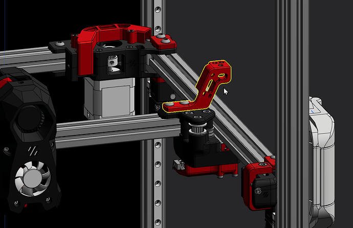

Sensorless homing on a core XY isn’t reliable.
Honestly, all I care about is the X axis.
Let me explain…
This little hook looking thing is were the drag chain attaches. Well, I’ve discovered that it’s the reason for several issues:
  1. Friction. Pushes drag chain outwards until the drag chain is touching the acrylic panel.
  2. Friction. This piece rubs against the drag chain and you can literally see white dust.
  3. Racking. While in use I can feel a hint of racking, it’s like the dragchain + hook thing exerts enough stress to the X axis that one of the two front idlers will be slightly racked (One or the other will have a slight play and some times not crash at all).
Sorry, It’s kind of hard to explain for me.
Seeing all the issues it was causing I figured I should just forgo the endstop switch and go sensorless homing.
What I find weird is that it’s not “unreliable” it’s not working at all.

This allows me to remove so may parts:
… and just having 2 cables (Stealthburner Nitehawk-SB usb cable + BA motor cable) really helps a lot when it comes to tuning the machine. You know… one less thing muddying up the waters.
