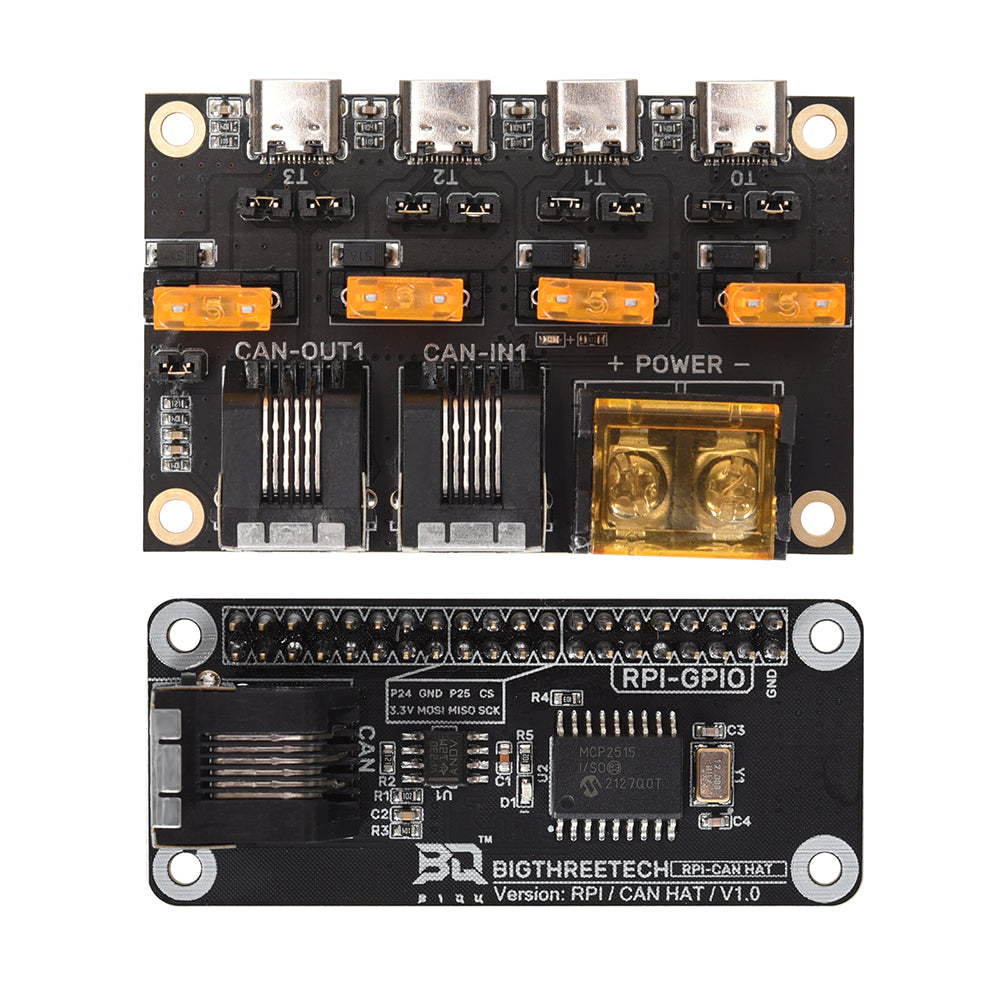

Scenario 1: The Canbus Distribution Board with SPI Adapter
You probably wouldn’t choose to lay out your canbus system like this now, but it’s worth covering first as early systems often worked this way.
The distribution board isn’t doing any processing or switching of the can signal, it’s just connecting the wires physically, and sometimes fusing the power rail to each connected device.
This topology would demonstrate a retrofit of a printer to have multiple tools and a rotary axis. The primary tool was NOT rewired from the primary mcu, the additional toolheads and rotary stepper were simply added on. It demonstrates that it is not necessary for the primary mcu to also be on canbus, as many older mcus (Arduino Mega, for instance) don’t support it.

Scenario 1: The CAN bus Distribution Board with SPI Adapter
You probably wouldn’t choose to lay out your CAN bus system like this now, but it’s worth covering first for historical context.
The distribution board isn’t doing any processing or switching of the CAN signal, it’s just connecting the wires physically, and sometimes fusing the power rail to each connected device. Even though it may look like a branching star topology, it’s still a linear network topology because all devices are communicating directly with each other on the line.
This topology would demonstrate a retrofit of a printer to have multiple tools and a rotary axis. The primary tool was NOT rewired from the primary MCU, the additional toolheads and rotary stepper were simply added on. It demonstrates that it is not necessary for the primary MCU to also be on CAN bus, as many older MCUs (Arduino Mega, for instance) don’t support it.
Some early CAN toolboards and SPI adapters had termination resistors soldered on with no jumpers, and it wasn’t always possible to create ideal schemas when adding additonal devices.

On another note, I’m experimenting with a transceiver form factor you might find interesting… It’s designed to go into a spare stepper slot on a Robin Nano v3 board…The first prototype should be in the mail for me when I get home.
It may be a miserable failure with the cap right under it, but I have been picking up PD0/1 for can from the SPI pins on the stepper (on Robin Nano v3) without problem, so I’m hopeful. :crossed_fingers:t2:
