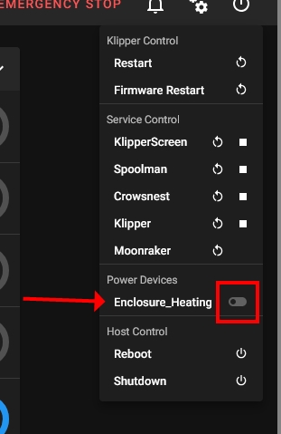

I upgraded my SV08 with an Enclosure Heating and Temperature Sensor. The Heating (220V) is controlled by a Shelly Relay switching on and off. This Relay is inserted in the “moonraker.conf” as a power device (see):

Now I want to use the “Status Information” of this Relay (if it is On or Off) in another macro; something like this:
[gcode_macro TEST]
{% if device_power device=“Enclosure_Heating” state=on %}
{action_respond_info(“Test On!”)}
{% else %}
{action_respond_info(“Test Off!”)}
{% endif %}
BUT this is not working (would have been to easy)!
So how can I get the Status Information of this Relay (because moonraker knows if it is On or Off) to write a macro?
Thanks a lot in advance.

it is a small 60 x 60 mm PTC Heater. BUT it is not about the Heater or the Sensor!! They are working fine, in my configuration.
It is about the Shelly Relay controlling this Heater (On / Off). I want to know if it is possible to receive the information about the Status of this Relay from Klipper/Moonraker?
In the list of the Power Button I see the Status of this Relay.
I can turn it on and off and the the Icon is changing. So I assume, that Klipper knows about the Status of this Power Device. But how can I call up this information?
I just supplemented the power entry in the moonraker.conf by the “poll_interval” point.
[power Enclosure_Heating]
type: shelly
address: 192.168.XXX.XXX
poll_interval: 5
Now Klipper is also noticing the power change of the Relay when I do it via the Shelly WebUI i.e.

I learned in the last weeks, that the status information (state) of a power device configured in the moonraker.conf is NOT available in Klipper (to use it in a macro)!
You can switch this device with macros in the printer.cfg of Klipper on or off, but you can not get the state of this device in Klipper for other purposes (i.e. macro “if …….. else………”).
This is my latest level of knowledge. If I am wrong, please let me know. Tks.
