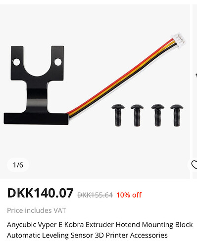

what about taking a different loadcell, for instance the one on the anycubic vyper.
That one looks generic, easier to integrate in various toolhead.
Edit: upload a picture of a spare, to show the shape, less than 20€
