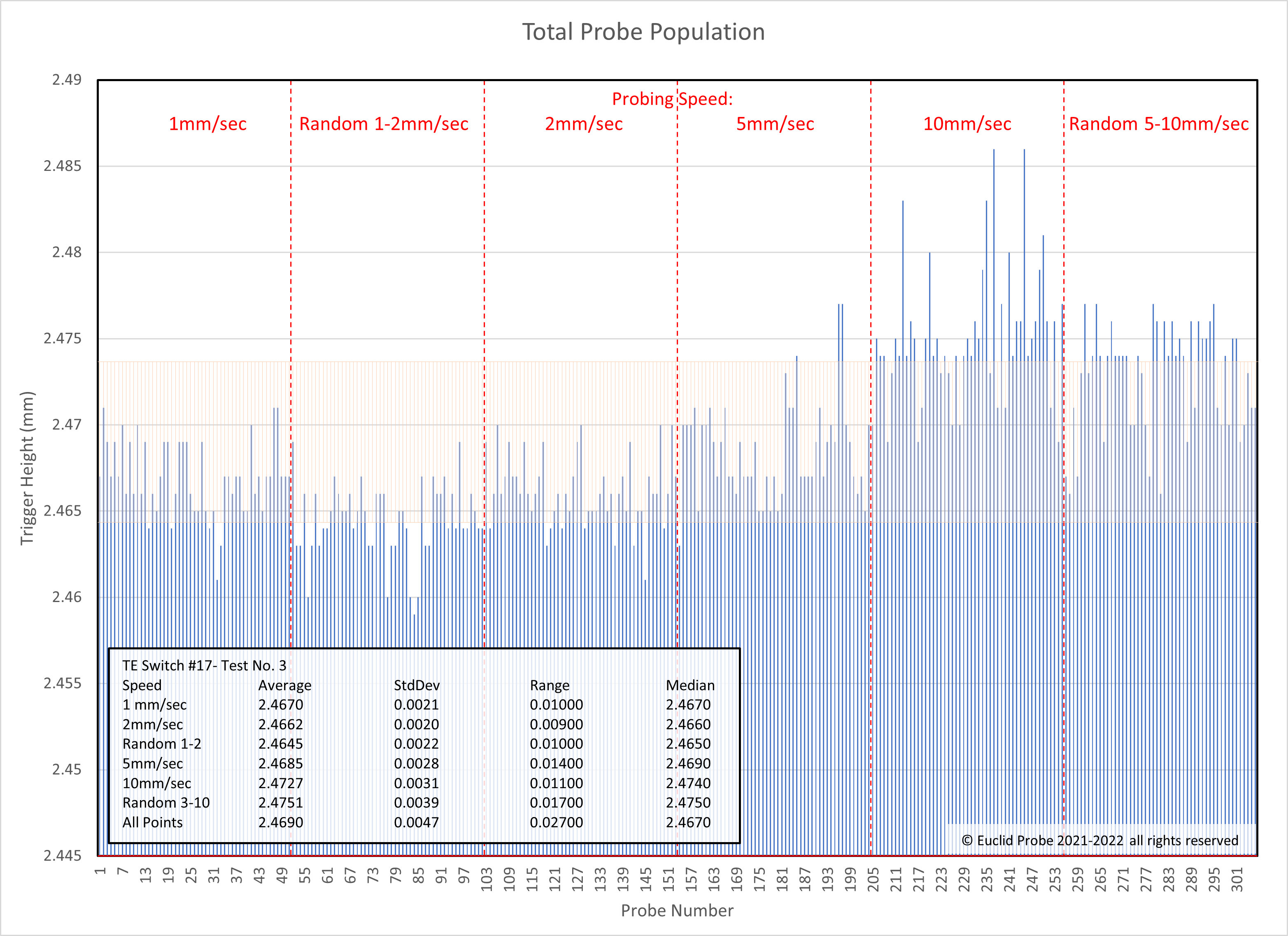

Something I have been meaning to do for a while is replicate Euclid’s accuracy testing results: Euclid Probe Accuracy | Euclid Probe the highly accurate detachable Z-probe for your 3D printer, laser and CNC see their graph here: https://euclidprobe.github.io/images/00-ProbeTest57_19_45-768x559.png
Their methodology is to do batches of 50 probes at various speeds. I had to do a modified version of PROBE_ACCURACY to do the randomization for the tests where its a speed range.
Here are the results:
speed maximum minimum range average median standard deviation
1mm/s 0.0172 0.0106 0.0065 0.0117 0.0116 0.0010
2mm/s 0.0136 0.0069 0.0067 0.0097 0.0098 0.0010
Random 1-2mm/s 0.0098 0.0066 0.0032 0.0078 0.0077 0.0007
5mm/s 0.0026 -0.0036 0.0062 -0.0015 -0.0018 0.0013
10mm/s -0.0104 -0.0167 0.0063 -0.0139 -0.0137 0.0014
Random 5-10mm/s -0.0093 -0.0153 0.0059 -0.0123 -0.0123 0.0014
Range
Euclid has an average range of ~0.01mm, load cell range is ~0.006mm in these tests. I think these results represent “real world” conditions, with a clean nozzle against a PEI build sheet. They are not idealized or cleaned up. There were, in fact, outlier points in the data that drove up that range, especially for the 1mm, 2mm and 5mm tests:
That means you get micron level accuracy in just 1 probe. When the probe is “wrong”, its a rare event and its wrong by less than 1/2 of Euclid’s error.
Absolute Value Range
Over 50 probes we start to see some things that you probably wont notice in real use. Looking at the data you might ask:
  1. The absolute value range from low speed to high speed is similar to Euclid, about 0.03mm. If you probe faster the results tend to be lower. Why is this when we are doing the pullback move?
  2. There is a clear trend to lower values of Z within each constant speed test set. Why is that?
Well, the harder you hit the bed, the more deformation you cause to the toolhead. There is some hysteresis so the toolhead doesn’t come back to its original shape instantly when it clears the bed. This is why faster probes result in lower Z values. Faster probes make the toolhead shorter.
So what we are actually seeing over the full speed range is the hysteresis of the toolhead. This toolhead has 0.03mm of hysteresis over the force range which is about 100g to 1.5kg.
As to question #2: range over 10 probes often approaches 0.001mm, a full order of magnitude better than Euclid:
