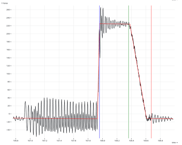

Quick report from my underbed loadcell testing: It’s already kind of working.
My setup contains one custom HX717 board and 4 underbed loadcells all wired to one sensor.
This is a probe
This was my config
[load_cell_probe]
sensor_type: hx717
dout_pin1: PB9

This is the result:
 13:32:20  $ PROBE
13:32:22  // probe at 250.000,250.000 is z=1.751975
13:32:26  // probe at 250.000,250.000 is z=1.751299
13:32:30  // probe at 250.000,250.000 is z=1.751461
13:32:30  // Result is z=1.751461
LOAD_CELL_DIAGNOSTIC output:
 13:37:31  $ LOAD_CELL_DIAGNOSTIC
13:37:31  // Collecting load cell data for 10 seconds...
13:37:41  // Samples Collected: 3029
13:37:41  // Measured samples per second: 303.4, configured: 320.0
13:37:41  // Good samples: 3029, Saturated samples: 0, Unique values: 1035
13:37:41  // Sample range: [3.18% to 3.20%]
13:37:41  // Sample range / sensor capacity: 0.00861%
One thing I noticed: My bed is kind of heavy. I have a 355x355x8mm aluminum buildplate. If I put my cup of coffee on my table, i can see it on the loadell output. I think the bed acts like a seismic mass turning the loadcell in an erthquake detector.
I had to lower the speed and put the trigger force up because I think the inertia of the bed already caused a trigger…
But its already really nice. Did not expect to come this far in that short amount of time :+1:
This is awesome! That is a whole lot of vibration (80g?!). And it works with inverted polarity! I never got the chance to test this, but I coded for it, so I’m really happy it worked :smiley:
Under a micron probe-to-probe!
Why 25hz?
I need to work on the diagnostic tool so its easier to copy the data from a probe into the notebook to to the analysis (like a link or button under each graph that copies the python to the clipboard). I’d live to drop this into the notebook and see if there are better settings for this printer.
That was just me trying out some values, I guess I forgot to remove it afterwards. I think i misinterpreted vibration as noise.
Also worth to mention that I used screened cable (actually I cut open an old usb cable) from sensor to all 4 load cell. At first I connected the screen of the cable with the grounding connection (aka earth connection or PE of the printer) - that resulted in terrible noise (± 60g). So I connected the screening to the negative terminal of the 24V power supply and that removed a lot of noise.
I used unshelled twisted pair Ethernet cable on my test rig and that improved things quite a bit. I still don’t think we, as a community, have a good formula for grounding and noise isolation yet.
What microstep rate are you using on Z? Is there one that is quieter/smoother?
Iā€˜ll have a look on that tomorrow, have to check on the microsteps
As it turned out, neither 16 nor 32 made a big difference in microsteps. It’s not that bad, i just had to raise the limits for triggering a bit. Also, trigger_count: 2 seemed to help a lot, since my vibrations are not one constant foce above 0 - its alternating. Currently this is working for me

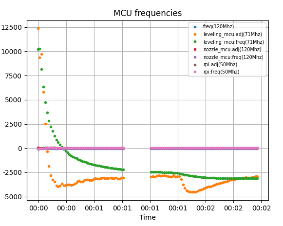

Just a note that we are making some headway with the Creality K1. Initially it was behaving in a way that was absolutely bizarre and I suspected that the MCU timer was unreliable. This was traced to incorrect implementation of the timer in the GD32 code and verified using graphstats.py to show clock drift under load:
@ZeyHex and I managed to re-write the timer initialization routine and configure the GD32 chips to implement capture & compare based timing like STM32. this fix 100% works. The bad news for K1 owners is that all of the MCUs need flashing to fix this. Time is position, accurate time is critically important.
Once we solved that we had fits trying to get rid of apparent ā€œESD noiseā€ on the sensor chips. This appears to be due to not reading the sensor for extended periods of time. If an hx71x chip goes unread for more than 1 sample period it seems it can flip bits on a subsequent read. I was able to reproduce this on the HX717 by trying to read it at 80SPS:
The timer/IRQ code we already have is sound so there wont be any changes for the single sensor version. But for the 4-sensor version we have to read every sensor that is ready immediately and save its reading. Then readings are reported to the host only when the first sensor reports that it has a sample ready. This makes the board appear the be a 4-channel synchronous sensor with the clock locked to the first sensor.
With a bit more debugging and configuration changes (this printer needs extra pullback_dist) we were able to get a PROBE_ACCURACY result with a range of 0.0037mm (3.7 microns). This is a pretty encouraging result given the slow sensors and oversized load cells. Huge shout out to @ZeyHex for the tireless debugging to get here!
We are still working through some gremlins. Most recently a ā€œTimer too closeā€ error on the main MCU. But I expect that we will get it to work soon…

We did find one issue with the algorithm that needs work. The K1 doesn’t have a high absolute peak force when the probe stops moving down. Maybe this is due to the low sample rate:
(Here the peak force is actually a noisy point far right of the elbow)
The current code looks for the peak force and expects that point to be the second elbow in the plot. It checks that the peak force is close to the blue line (trigger time) and will reject the probe if it is now. I’ll have to work on a strategy for finding this ā€œsoftā€ elbow that is more robust. (I have good elbow finding code I just need to use it here)
