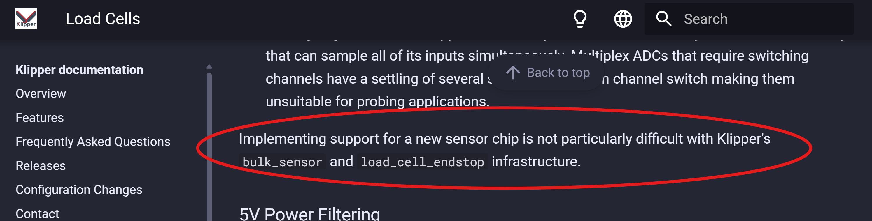

Writing a driver for ADS131M shouldn’t be too hard. its going to look a lot like the driver for ADS1220 since they are both SPI sensors. The programming section of the manual is here.
It has 4 channels and has a much larger register map, but odds are you only need to implement one channel and a handful of features (input selection, data rate, PGA) to get things up and running. All of the device setup is done in Python (setting and verifying registers etc.) The actual reading from the device is in C, but you are scoped down to just having to read the bytes out of the device and then convert the data to an integer.
All the hairy math stuff is totally offloaded to other modules in C and Python. Somebody ambitious could take a crack at this.

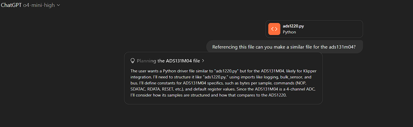

:rofl: I know a coder whos REAL ambitious, but not very good :sweat_smile:
Checkout what chatgpt put together. This is mostly a joke but I’m curious how it did at the same time.
ads131m04.zip (3.2 KB)
