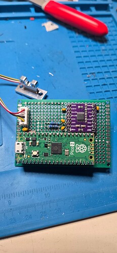

No I will not show the back where all my routing is done, I want to maintain some reasonable doubt in y’all’s opinions that I’m not a complete idiot :sweat_smile::rofl:

So using GitHub - mulcmu/Plimsoll: Kicad PCB design with XH717 ADC to support Klipper load cell along with the fysetc load cell when probing at 2mm/s I see around 250g at trigger. Slowing down to 0.5mm/s I see 50g at trigger and 0.05mm/s I see about 20g at trigger. So multi mcu homing/speed is a real factor at play here. FYI
EDIT: No real difference on my ads1220/pico board.
Is this normal?

@53Aries asked if his results concerning peak force VS travel rate were normal using his 2 different boards.
As far as realigning the force/position data in the time domain… you are way ahead of me!
I think so. On my single mcu system I’m seeing like 140-200g at 2mm/s.
