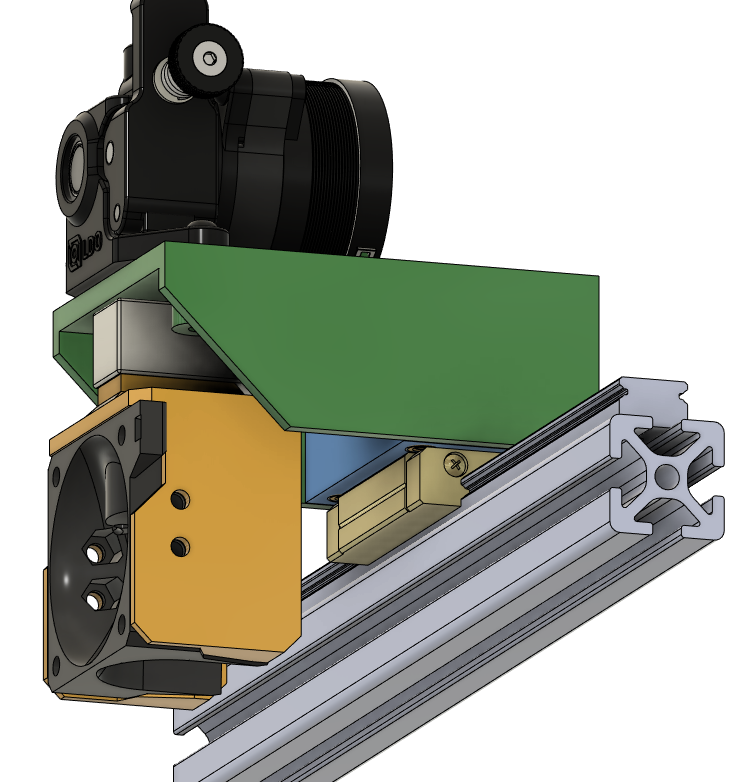

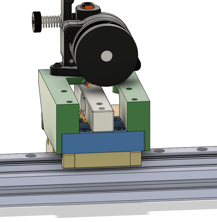

I just started modeling something up in Fusion360, not conforming to any standards, just trying to get something on one of my old printers that uses a linear rail on the X-axis. But I did import an EVA3 hotend adapter and modeled around that, which made that part of the design pretty straightforward.
In the pictures, the extruder is mounted to the green part, the hotend to the yellow part attached to the the strain gauge. This means when the extruder pushes filament into the hotend, it will push the green and yellow/strain parts away from each other. However, this relies on me drilling a 4mm thru-hole in the strain gauge for the PTFE to pass through.
These bar strain gauges are not ideal, but it’s what I had and it’s not terrible either. Have done nothing with it yet. Got a few other priorities, but I already printed parts to give myself some motivation to start playing with it. I have an HX711 amp though it sounds like the sampling rate on that might not be good enough. Open to recommendations.
(I have more pictures but my social rating doesn’t allow me to attach more than one)
I can only attach one picture per message, so here’s another message :slight_smile: That should be enough to see what I’m doing here.

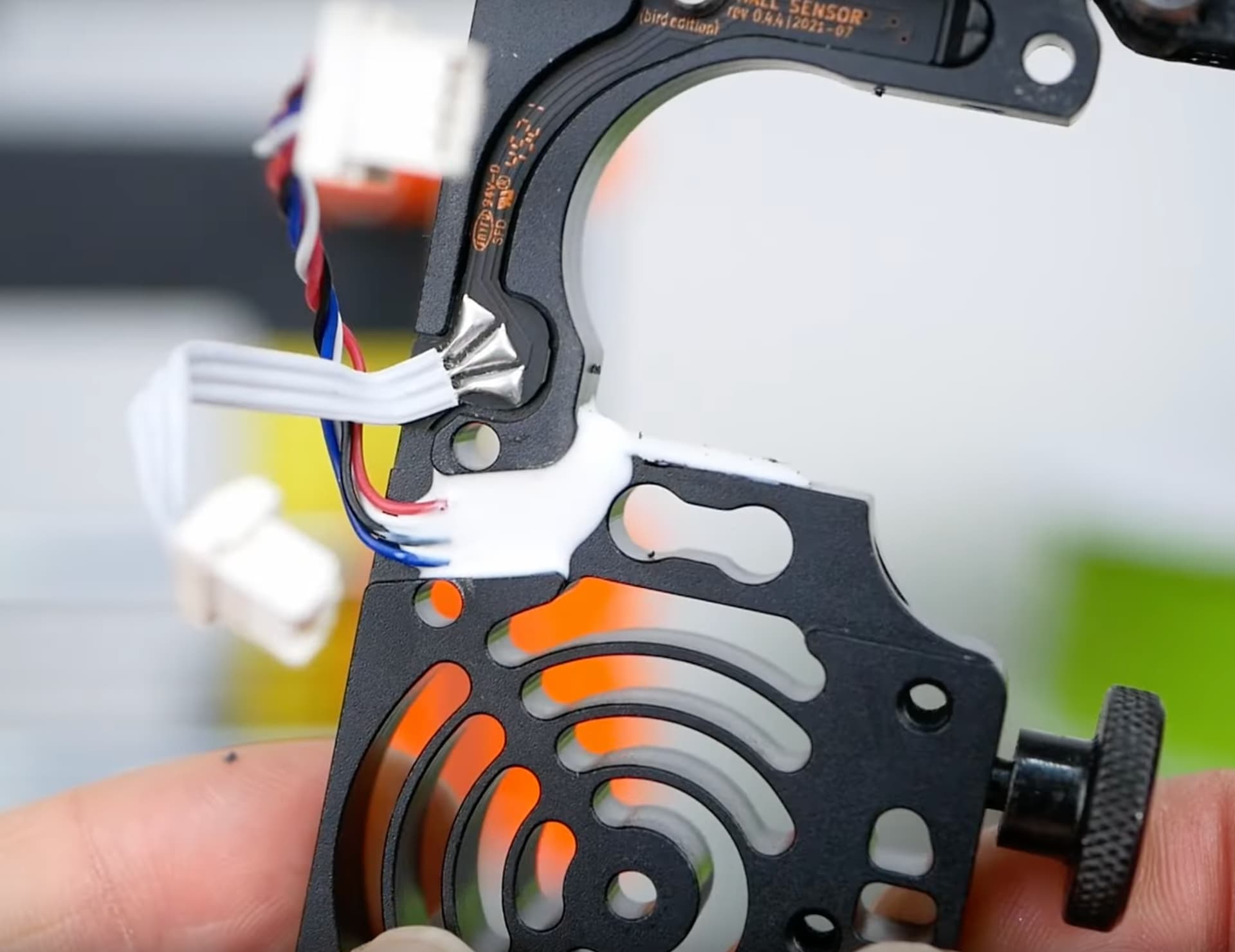

CNC Kitchen is out today with a good teardown video of the MK4 toolhead and you can see where the strain gauge is: Who would even buy a new Prusa MK4 in 2023? - YouTube

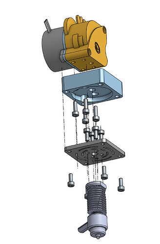

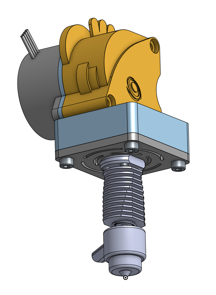

This is the other strain gauge idea that I’ve had. Its based on a flexure membrane which allows motion along the Z axis and twist about the X and Y axes. This allows for probing in the X/Y and Z axes with about the same amount of strain in the membrane for each.
It has some pros:
  • This one is designed to be cut with a fiber laser out of 3mm thick 6061 Aluminum, which is a very cheap process
  • If you step up to a Wire EDM process the part can get even smaller in X/Y.
  • The mount (blue part) that connects it to the extruder can be a 3D printed part that’s easy to integrate into a toolhead.
  • Potential for a very short distance between the extruder and hot end.
The major cons are:
  • The 40mm x 40mm footprint in the X/Y plane which is going to interfere with part cooling in a lot of existing toolhead designs.
  • This is not as well tested as beam load cells.
  • I suspect that 2 strain gauges will be needed to capture X and Y strain.
  • The strain gauges have to be very small.
(I’m mostly posting this to create prior art so these ideas stay Open Source :wink:)

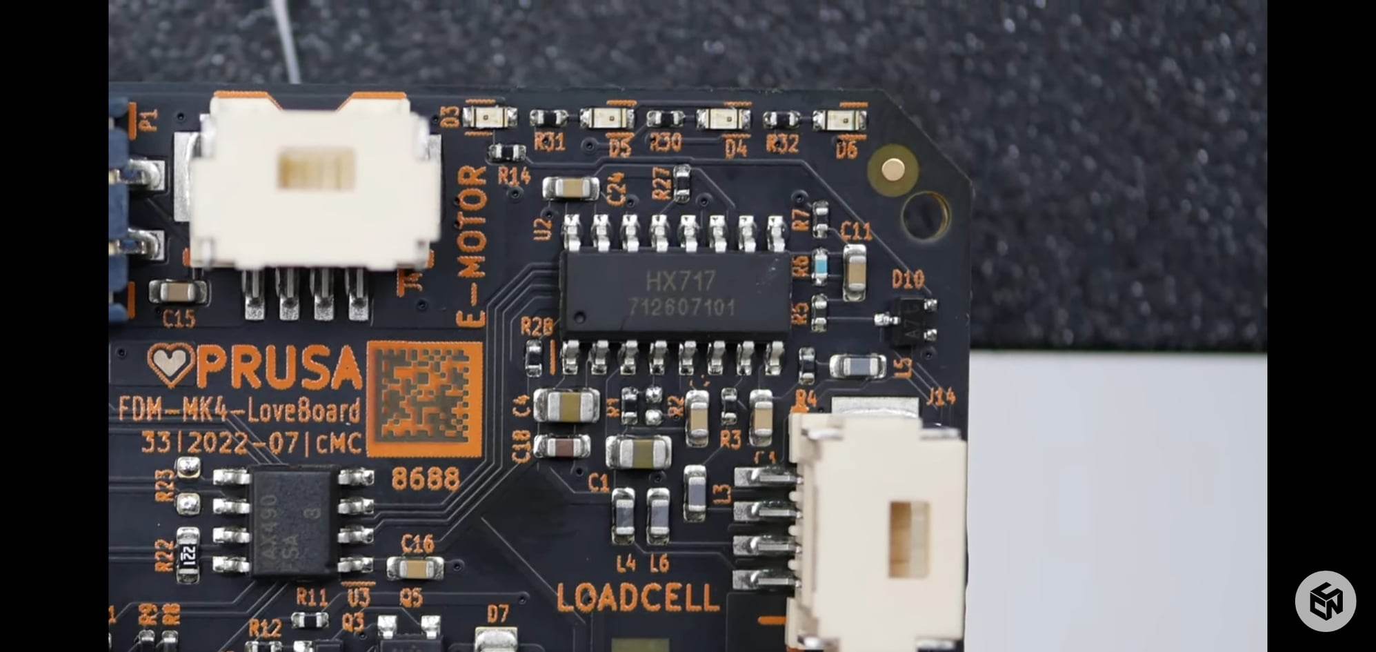

I see that :Prusa are using the HX717 (load cell amplifier?)
which I suspect is very similar to your HX711 board?
I also like Prusas approach to having the strain gauge mouted into a monolithic aluminium block that connects directly between the extruder and hot end for consistency.
