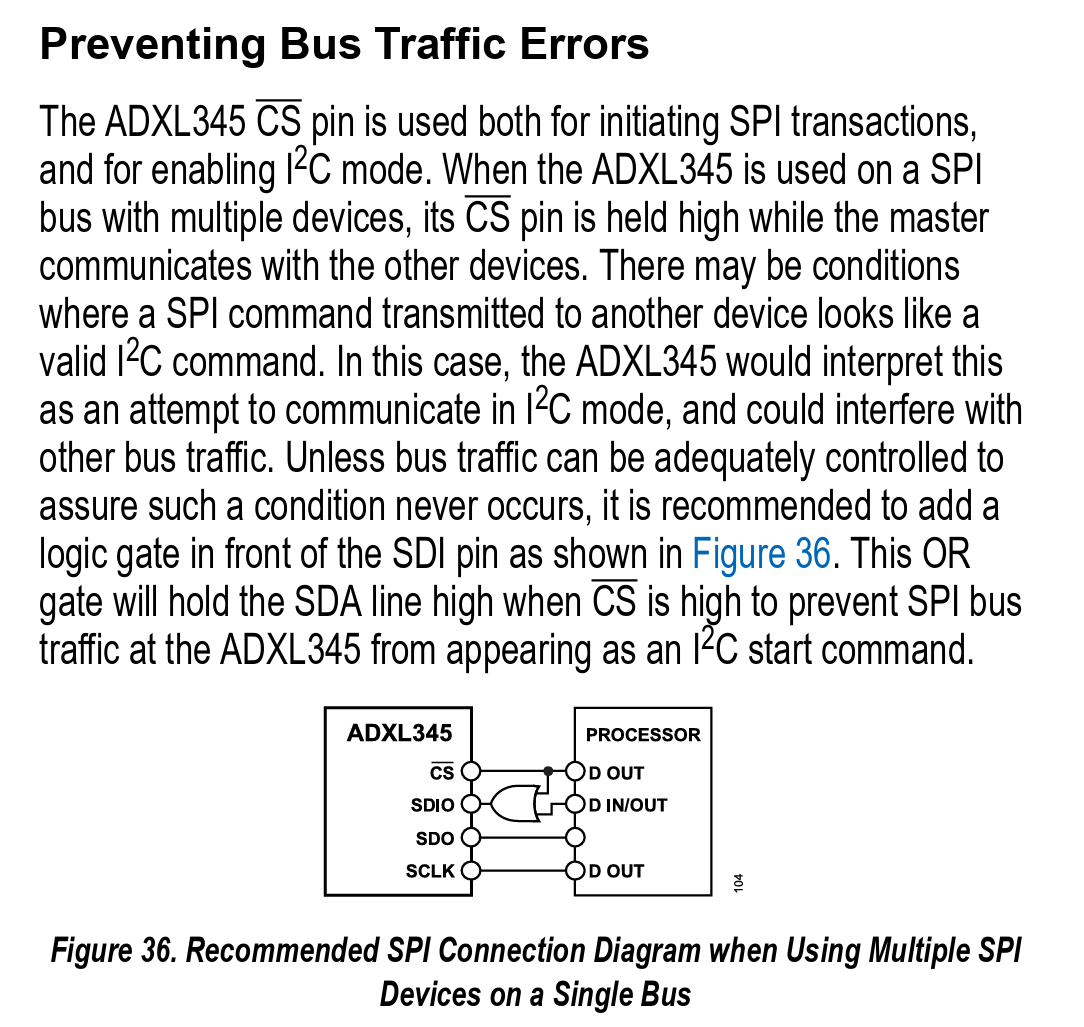

Not 100% true. There is the possible I2C/SPI conflict that you can get with the ADXL345 and other SPI devices where the I2C start conditions can appear to the ADXL345 which results in it responding as an I2C device, causing bus contention with the other device(s) on the SPI bus:
The first time I set up an ADXL345 on a printer, I also had a BTT Mini 12864 display on the same bus and nothing worked right after that.
This is why I only recommend using the ADXL345 on SPI buses that don’t have any other devices on it - unless the controller board was designed by an exceptionally smart engineer.
