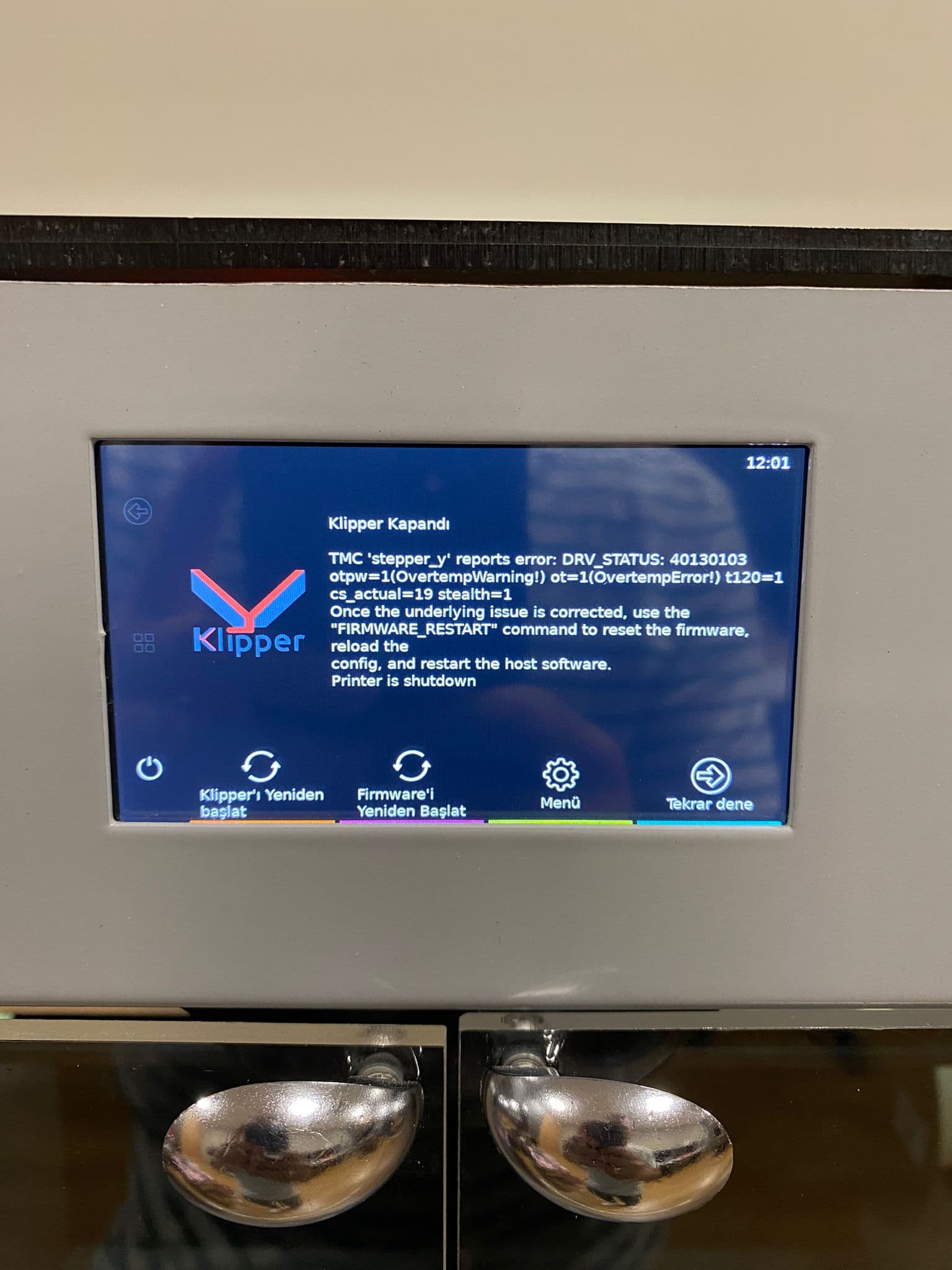

I’m encountering the following error with my Klipper-powered printer and the printer shuts down:
TMC ‘stepper_y’ reports error: DRV_STATUS: 40130103
otpw=1 (OvertempWarning!)
ot=1 (OvertempError)
This indicates that the Y-axis stepper driver is overheating. The screen shows “Klipper shut down” and suggests restarting the firmware.
I’ve checked and confirmed that the fans are running. Cooling appears to be sufficient, but the issue persists.
What could be the cause of this error, and how can I solve it permanently? Any help would be greatly appreciated.
Thanks in advance!

Transition to shutdown state: TMC 'stepper_y' reports error: DRV_STATUS: 40130103 otpw=1(OvertempWarning!) ot=1(OvertempError!) t120=1 cs_actual=19 stealth=1
This error is raised by the driver itself and only communicated to Klipper
A RMS current of 1.1A for a TMC 2208 should be working when sufficiently cooled
I would think:
Either insufficient cooling
Defect driver
