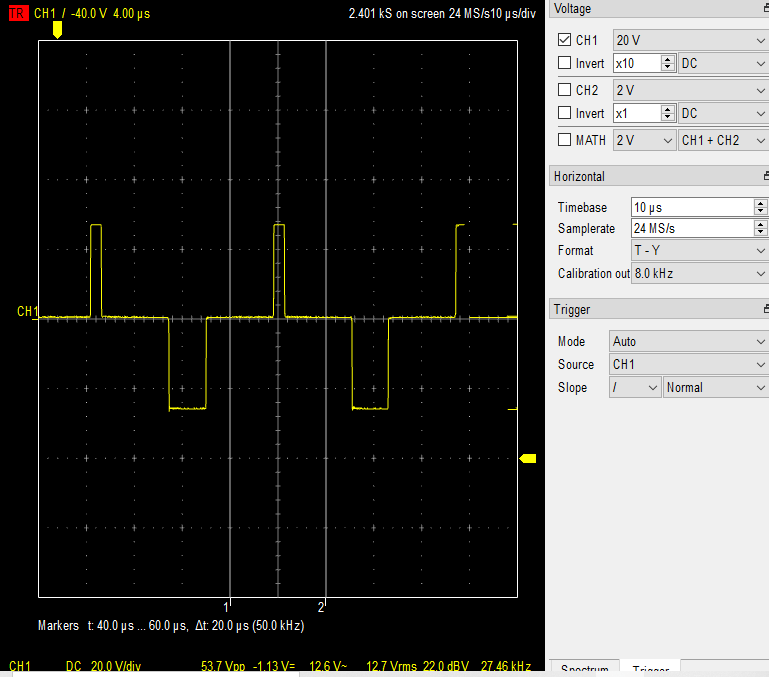

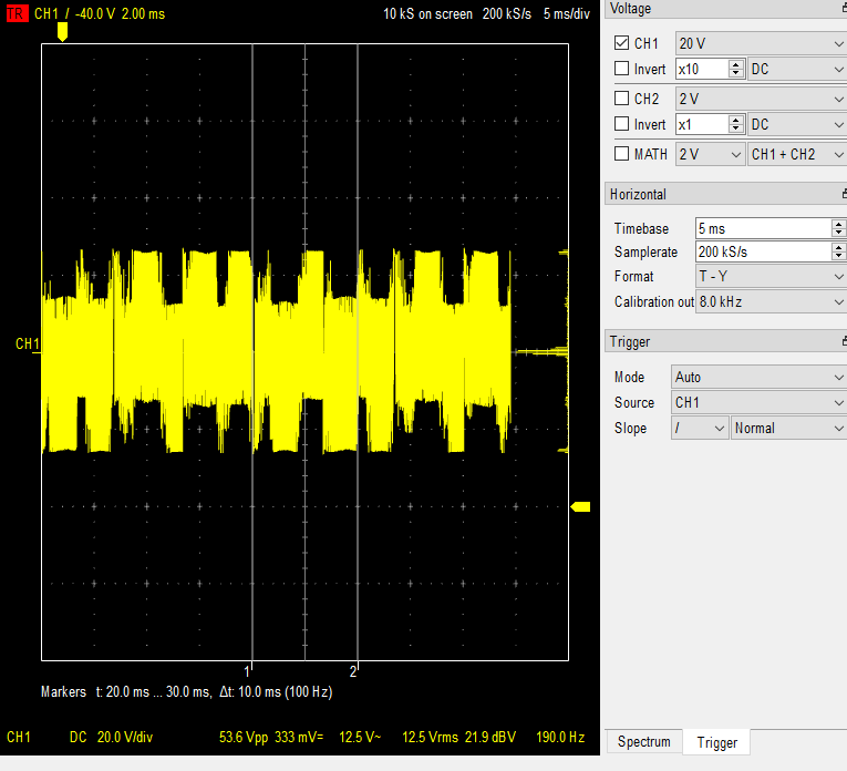

hi,
i am running a duet wifi clone ( as i burned-up my original one ).
when trying to get my steppers to run at an acceptable noise level i noticed something strange.
it looks like there is a high frequecy parasite on the output it kind of looks like an H-bridge switching output.
I am not an expert on using a scope so maybe i am wrong here and please correct me.
i am however pretty confident in my scope setup because when i rotate the motor by hand at these settings, i get a clean sine wave. when i run the motor via the duet, i only see a lot of distortion.
maybe this is be typical for the clone duet but the motors where running verry noisy/ agressive on my orriginal duet to.
does enyone know what i am doing wrong here?
accourding to the tuning instructions for the TMC2660 driver i should see a sinewave and be able to “clean it up” with correcting the settings.
but the way the sine wave looks,… wel, it is hardly a sign wave.
if there are any tips for tuning the TMC2660, please let me know because there is a lot of info arround but nothing seems complete.

Motors, of any kind, are essentially impossible to put on an oscilloscope and get meaningful information from the voltage waveform. When you see something like this in a datasheet:
It’s generally an image of the driver providing current to a resistor. Motor voltages are all over the place with Back EMF and noise really making a mess/hash of things.
That actually goes back to your observation that the output looks like a traditional H-Bridge and it is with the current actually being varied and not the voltage (which is why I noted that for the waveform diagram, they’re measuring the current across a resistor and not across a motor’s terminals).
I had a product which I changed from DC motors to steppers and struggled to get them working acceptable but was lucky enough to get some coaching form a Trinamic FAE on the process of working with microstepping stepper motor drivers to understand what you’re looking for in order to get best performance (which equates to lowest noise). If you want to see what’s really going on, you’re going to need something like this between the driver and the stepper motors to provide meaningful waveforms on your oscilloscope:
https://www.trinamic.com/products/modules/details/tmcm-0013-xa/
What are the tuning instructions that you are working with? I’m really surprised they say that you should see a sine wave (as even when I started on the product, I knew you can’t get anything meaningful out of any kind of motor by just looking at the voltage).
