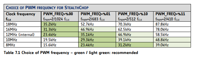

You can try increase PWM_FREQ.
*same about SpreadCycle, there are also frequencies to play.
IIRC, increasing of TBL - will decreasing frequency, and vise versa.
You can find approximate frequency it in TMC5160 spreadsheet, where you are tried to find optimal parameters.

I’ll definetly try messing with PWM_FREQ

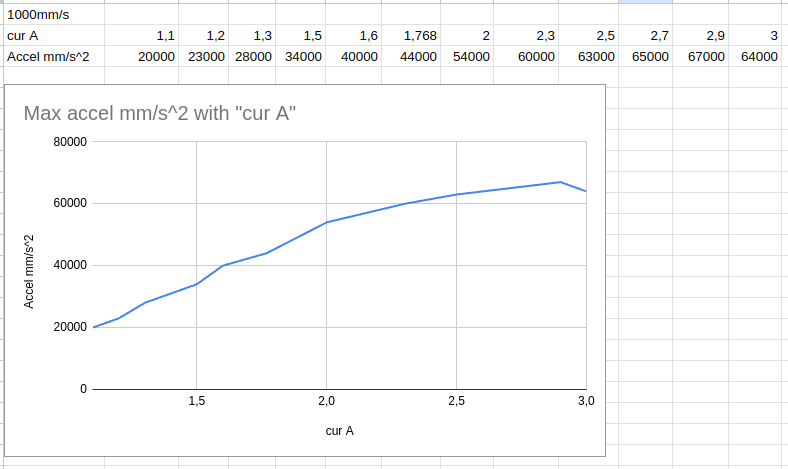

My 2 cents, I have LDO2504 (rated 2.5A, so I use 1.768), and StepSticks 5160 48V
I’m able to overdrive motors (I only tested that to see a correlation between Ampers and Torque).

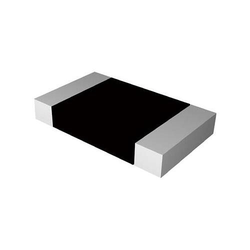

Check Digikey or Mouser. This type is called ā€œcurrent sense resistorā€.
TBH, I’m not so sure if BTT really lives up to this 0.1% promise, as you hardly get any with this rating (Mouser is like 2 from a total of 40000 resistors in their list).
I settled for 0.5% if I remember well.

That makes things easier I think, on Mouser 0.1% resistors cost as much as the drivers… I’ll keep searching
The link provided by mykepredko could be a good option, I’ll have to check if they ship to italy. Still quite expensive though.
edit: this seems fine and reasonably priced
