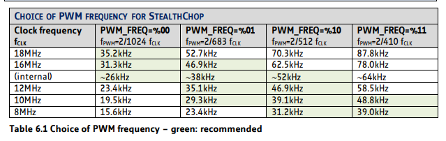

I searche dthe datasheet and found nothing specific about the ninimal required motor inductance. There are two Parameters called PWM_FREQ and TOFF (in the TMC2130 Datasheet) which are controlling the chopper frequency. My try right now is seeting the chopper frequency higher (test running) because i suppose thats what might cancel out the lower inductances (but I’m not very sure, but I did run out of ideas)

TOFF is SpreadCycle specific.
PWM_FREQ is StealthChop specific.
PWM_FREQ, even if I understood this parameter,
I do not know why it exists or why anyone would want to mess with it.

I calculated TOFF and PWM_FREQ so that it would lead to about double the default Frequency (at least thats what I hoped to achieve)
I definately missed that part which said PWM_FREQ is StealthChop Specific, but I definately see it now:
So it might as well have backfired.
I tried this, because my original Motor had about half the inductance and I figured that I might run into some coil-saturation or something like this.
But I’m definately not a motor-specialist.
the TOFF and PWM_FREQ did however change nothing and I simply let them in because…
I remove them now as they definately should not be needed by now anymore

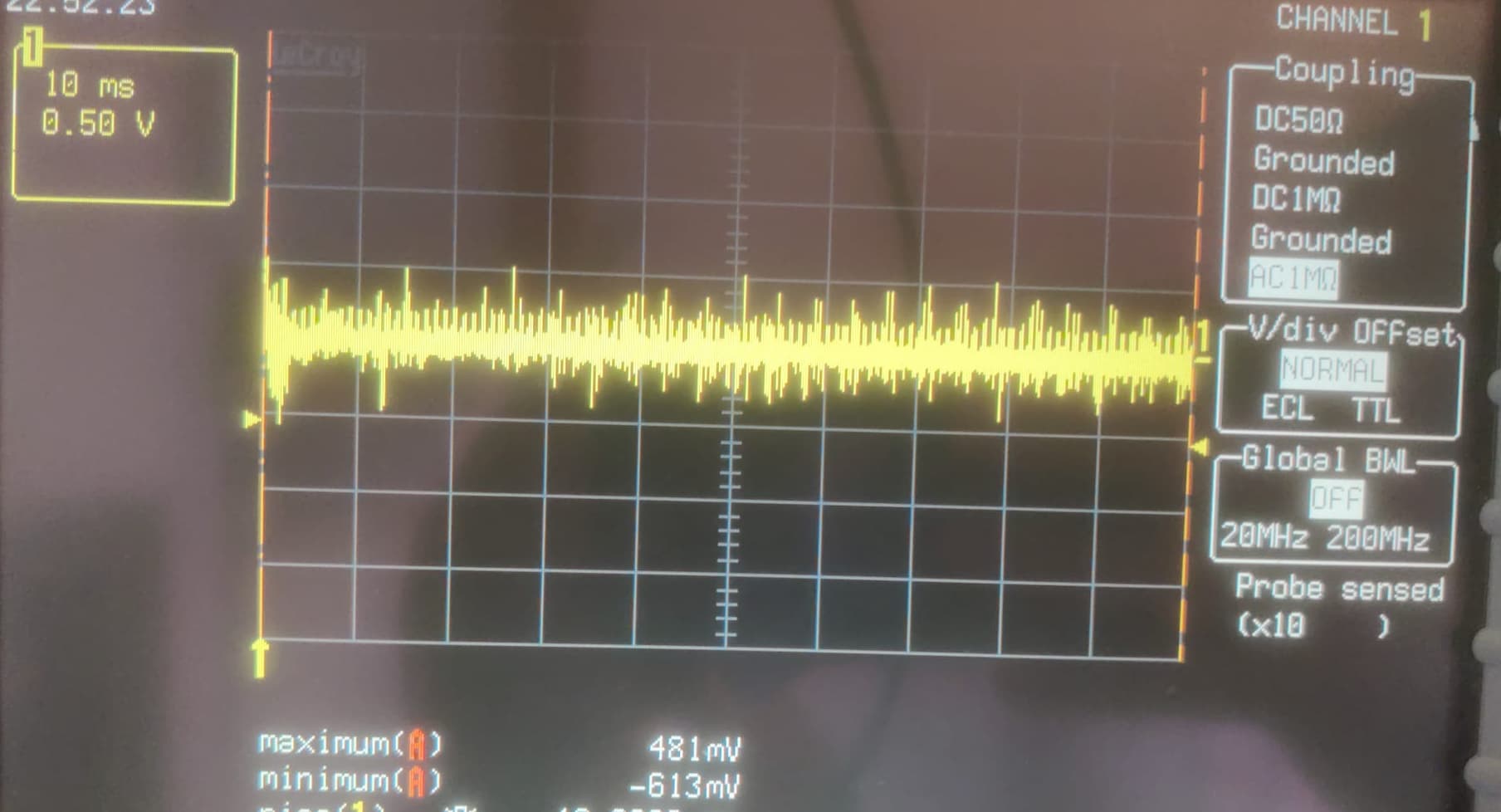

All Right,
After hooking up a shielded cable I have about 150mV Ripple on the 20V Rail. Which is acceptable I guess…

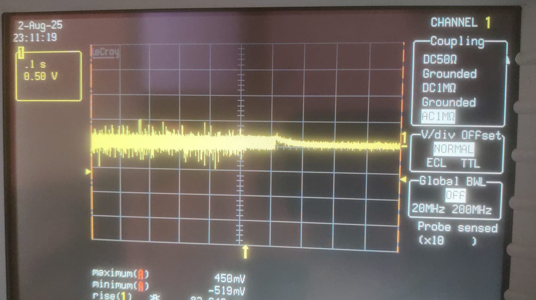

What I do see is about a 1V Ripple, which I is composed of some high-Frequency Noise from the stepper motor, as well as some lower frequencys from the heater switching (I increased the switching frequency drastically so that the additional capacitance have a greater effect)
Right now I’m running again to see if I can catch some particular drop in the motor-Voltage which triggers the stepper reset.
I Believe this is the event the driver died. And to be fair I do not see any reason at all why it would die in this moment…

+/-500mV of noise/ripple is a lot. If you’re running a TMC2209 or TMC2130, according to their datasheets, that’s enough to cause errors in the sense resistors and cause the driver chip to shut down (which is what I think you were seeing with the OLA/OLB errors). Excessive ripple can also damage the internal charge pump capacitors.
