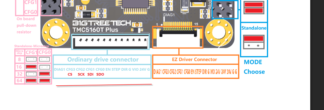

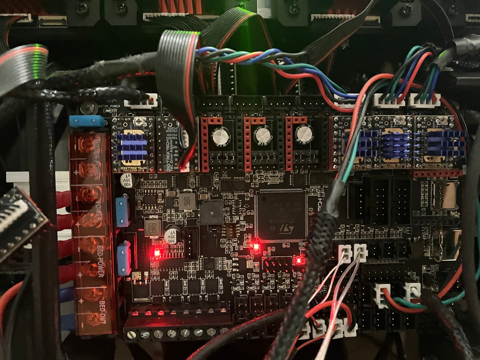

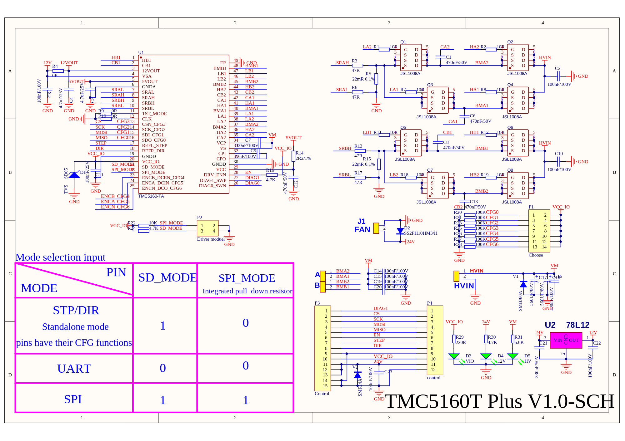

Setup details that could help to understand my configuration:
  • All jumpers on the Octopus Pro are set for SPI mode.
  • The board is powered by a 24V power supply.
  • The TMC5160T Plus drivers are powered by a dedicated 48V power supply.
  • Jumpers for each driver are set to use MOTOR_POWER, not BOARD_POWER.
I’ve not connected any 48V voltage to the MOTOR_POWER terminals on the Octopus Pro, just directly to steppers.
I already damaged a board in the past, so I’m being extra cautious.
Could the lack of motor power to the board itself be causing SPI communication issues?

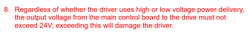

I’ve attached:
Thanks in advance to anyone who can help! :folded_hands:
Let me know if you need pictures or more details.

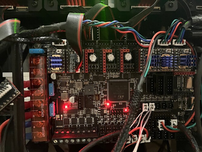

I’ve tried several things without success:
  • Removed the 48V power supply and used only 24V, connected to VIN, V_MOTOR_POWER and directly to drivers
  • Switched the driver power jumper multiple times between VIN and V_MOTOR_POWER
  • Tried each of the four TMC5160T-Plus drivers individually in the stepper_X position
But I’m still getting the same issue.
It’s all very strange, this is already the third Octopus Pro board I’ve bought.
My next step is to recreate the printer.cfg from scratch, but I still can’t figure out whether the problem is:
  • a hardware wiring issue
  • a software configuration issue
  • or some kind of hardware damage due to incorrect wiring
