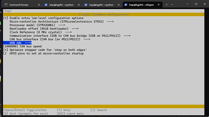

.config (for Manta M8P, in this case) is as follows:

Is this a known issue, or is something broken with my env? I’m using stock Debian 12 on the SOQuartz to build and flash Klipper.
Could you post:
A screen shot image of make menuconfg, rather than a dump of the .config file like:
I think what I’m showing above are the parameters for the firmware image that you want to build.
Explain the procedure you followed for loading Klipper onto your SOQuartz v1.0. I believe that this is in the CM4 form factor -correct?
Have you loaded any other modules into klipper? Providing your latest klippy.log would be helpful.
I can imagine two reasons for this:
  • Corrupted make file left-overs. Correct with:
make clean
make distclean
make menuconfig
  • Modified Klipper sources that now clash with the update
No modifications were made to the repo, this occurs with a freshly and manually cloned repo from GitHub - Klipper3d/klipper: Klipper is a 3d-printer firmware. Procedure for loading Klipper initially was KIAUH 6, but I manually redownloaded it once it broke during linking the first time. The SD card isn’t failing, the filesystem reports no issues and no read errors are reported with dd.
You are correct that it is CM4 form factor, it clips directly onto the Manta M8P.
Well, I did try your config.
And it clearly does not work.
But if I do, as mentioned above, the make menuconfig, which does, updates the config to the current state.
It works.
So, generally, your old config may not work, it is expected. It is expected that once upon a time, you have to run make menuconfig or make olddefconfig to update it.
Hope that helps.
