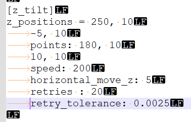

Unable to parse option 'z_positions' in section 'z_tilt'
What am i doing wrong here? It is a cartesian with dual indipendent Z motors and cannot use Z_tilt.

Try it this way:
[z_tilt]
z_positions:
    250, 10
    -5, 10
points:
    180, 10
    10, 10
speed: 200
horizontal_move_z: 5
retries : 20
retry_tolerance: 0.0025
BTW: it is the = instead of a :

Looks like, you have surpuls tabs in your cfg:
grafik
Needs to look like @EddyMI3D has posted above.
Thank you. I just copied from another post from @EddyMI3D and changed parameters and it worked. Still do not understand what was wrong.

The parameters have to start at a new line, not after the identifier (z_positions:/points:)
