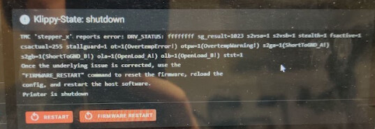

Unable to write tmc spi 'stepper_x' register GCONF after Overtemp
Hi all, I recently got an overtemp error on my tmc5160 pros I was only running 2 amps for a couple minutes. I am now getting “Unable to write tmc spi ‘stepper_x’ register GCONF”. I even swapped the drivers and I still get the error.
Any help is appreciated
