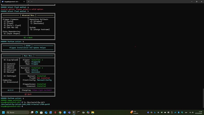

Hello everyone, it’s a pleasure to greet you again. I’m making another attempt to work printing with [unclear - possibly β€œthe guy from Spain” who tried to connect without success]. I hope you’re doing well and I’m waiting for your response.
I have a flashed Chitu v6 tablet connected to my BTT Pi, but I can’t get it to connect. Here’s all the information I have. If anything is missing, that would be great. Please work on it. Best regards from Spain.

Did you use a SD card to update the firmware on the mainboard?
I can’t find a β€œofficial” set of instructions but there seems to be 2 different bootloaders used by Tronxy on these boards. the first updates with a .cbd file and the later version with a .bin file.
The Tronxy website is worse than useless. All their firmware downloads send a zipped gcode file full of Chinese characters that I can’t decipher.
If you unplug the USB cable and power on your printer does the screen work? If so you are still running Marlin firmware and will have to flash again.
I need to flash the board again; it’s a CXY-V6-191017. I’m completely lost on how to compile and flash the firmware. SOS.

Select flash command: 2
β•‘ Make sure that the controller board is connected now! β•‘
β•Ÿβ”€β”€β”€β”€β”€β”€β”€β”€β”€β”€β”€β”€β”€β”€β”€β”€β”€β”€β”€β”€β”€β”€β”€β”€β”€β”€β”€β”€β”€β”€β”€β”€β”€β”€β”€β”€β”€β”€β”€β”€β”€β”€β”€β”€β”€β”€β”€β”€β”€β”€β”€β”€β”€β”€β”€β•’
β•‘ How is the controller board connected to the host? β•‘
β•‘ 1) USB β•‘
β•‘ 2) UART β•‘
β•‘ 3) USB (DFU mode) β•‘
β•‘ 4) USB (RP2040 mode) β•‘
β•Ÿβ”€β”€β”€β”€β”€β”€β”€β”€β”€β”€β”€β”€β”€β”€β”€β”€β”€β”€β”€β”€β”€β”€β”€β”€β”€β”€β”€β”¬β”€β”€β”€β”€β”€β”€β”€β”€β”€β”€β”€β”€β”€β”€β”€β”€β”€β”€β”€β”€β”€β”€β”€β”€β”€β”€β”€β•’
β•‘ B) Β« Back β”‚ H) Help [?] β•‘
β•šβ•β•β•β•β•β•β•β•β•β•β•β•β•β•β•β•β•β•β•β•β•β•β•β•β•β•β•β•§β•β•β•β•β•β•β•β•β•β•β•β•β•β•β•β•β•β•β•β•β•β•β•β•β•β•β•β•
Select connection type: 1
Identifying MCU connected via USB …
β•‘ !!! ATTENTION !!! β•‘
β•‘ Make sure, to select the correct MCU! β•‘
β•‘ ONLY flash a firmware created for the respective MCU! β•‘
β•‘ β•‘
β•Ÿβ”€β”€β”€β”€β”€β”€β”€β”€β”€β”€β”€β”€β”€β”€β”€β”€[List of detected MCUs]────────────────╒
β•‘ β•‘
β•‘ 0) usb-1a86_USB2.0-Serial-if00-port0 β•‘
β•‘ β•‘
β•‘ B) Β« Back β•‘
β•šβ•β•β•β•β•β•β•β•β•β•β•β•β•β•β•β•β•β•β•β•β•β•β•β•β•β•β•β•β•β•β•β•β•β•β•β•β•β•β•β•β•β•β•β•β•β•β•β•β•β•β•β•β•β•β•β•
Select MCU to flash: 0

Wrote and verified address 0x08008000 (93.67%)
Wrote and verified address 0x08008100 (94.40%)
Wrote and verified address 0x08008200 (95.13%)
Wrote and verified address 0x08008300 (95.86%)
Wrote and verified address 0x08008400 (96.59%)
Wrote and verified address 0x08008500 (97.32%)
Wrote and verified address 0x08008600 (98.06%)
Wrote and verified address 0x08008700 (98.79%)
Wrote and verified address 0x08008800 (99.52%)
Wrote and verified address 0x080088a8 (100.00%) Done.
Starting execution at address 0x08000000… done.
Start klipper.service …
[OK] OK!
[OK] Flashing successful!
printer (2).cfg (2.7 KB)
Excellent work - looks like it took the upgrade.
Go to the Machine tab in mainsail and click [Devices]
Highlight serial and click refresh. Copy the device_by_id to your printer.cfg.
save and restart
Send a new klippy.log of it still won’t connect.
